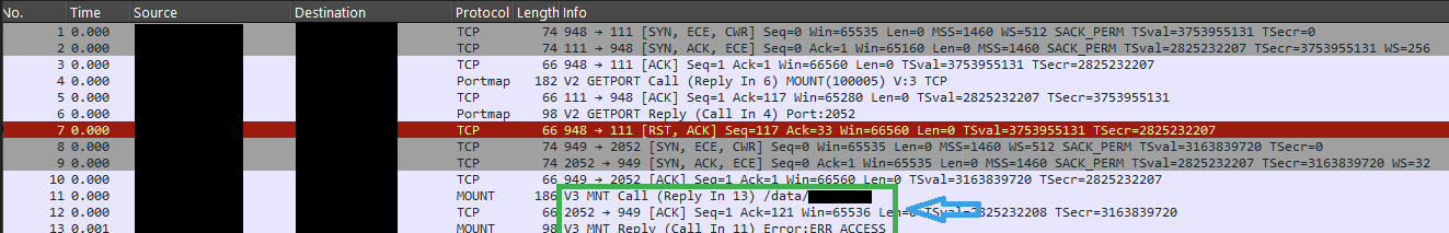

    4 . Perform a packet capture from Source host to target NFS storage IP, Below error will be seen for permission issue.
    • Modify the permissions on the NFS share  from no_all_sqaush to all_squash on the storage end, (sec=sys,rw,no_root_squash,all_squash,insecure,version=3)
