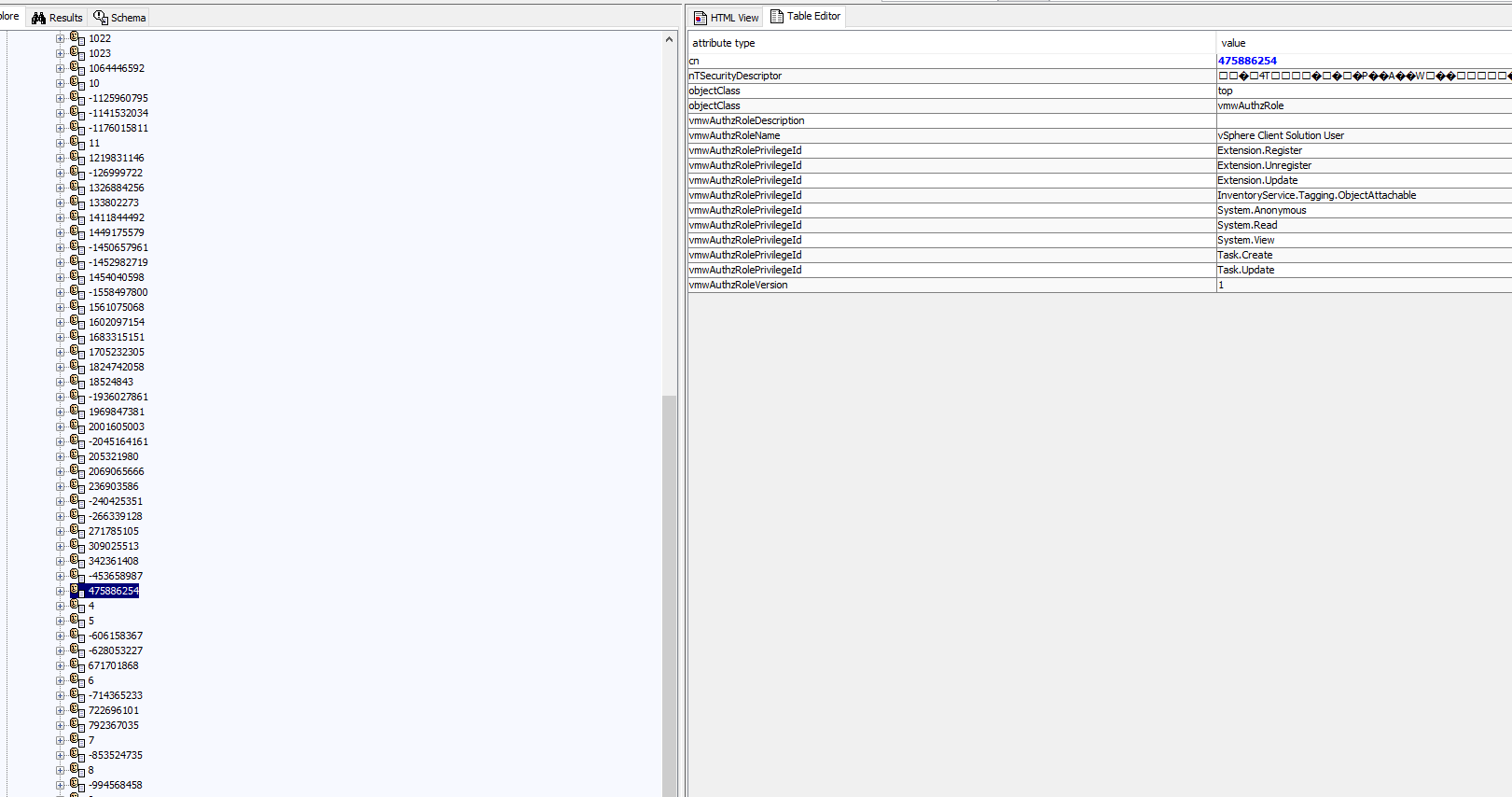

  1. On the right-hand side, click on "Table Editor."
  2. Review and record the entry for attribute type "vmwAuthzPermissionRoleId."
  3. The value of vmwAuthzPermissionRoleId for the two above components should be '1003." If the value differs, for example: 475886254, the role will be deleted in below steps.
  1. Review and confirm RoleID 1003 exists by navigating to:
    1. World > local > vsphere > Services > VmwAuthz > RoleModel
  2. Confirm RoleID 1003 has the following privileges per the screenshot.
  1. If the two components mentioned in Step 4 does not have vmwAuthzPermissionRoleId = 1003, update the value for both components as needed.
    1. Navigate back to World > local > vsphere > Services > VmwAuthz > AclModel.
    2. In the Table Editor view, select the current vmwAuthzPermissionRoleID value, for example, 475886254, and replace it with 1003.
    3. Click Submit at the bottom to save.
  2.  Delete the stale roleID entry of 475886254 under World > local > vsphere > Services > VmwAuthz > RoleModel.
