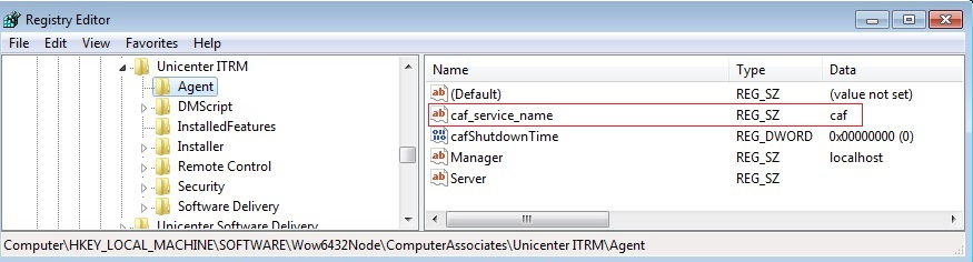

These errors appear because the registry value caf_service_name is not found under registry key
HKEY_LOCAL_MACHINE\SOFTWARE\ComputerAssociates\Unicenter ITRM\Agent
(or HKEY_LOCAL_MACHINE\SOFTWARE\Wow6432Node\ComputerAssociates\Unicenter ITRM\Agent
on a 64 bits machine).

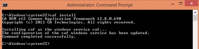

1- Execute the command "caf install" using the command prompt:
(OR)
2- Execute the following command in a command prompt:
reg ADD "HKLM\Software\ComputerAssociates\Unicenter ITRM\Agent" /v caf_service_name /t REG_SZ /d caf /reg:32 /f
