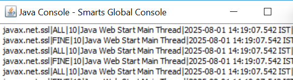

Viewing the java console log:
  1. Stop and restart the webconsole (web browser on the client machine). The Tomcat server does not need to be restarted.
  2. Java Console should load, along with the the java prompt.
  3. Approve prompt to run the application.
