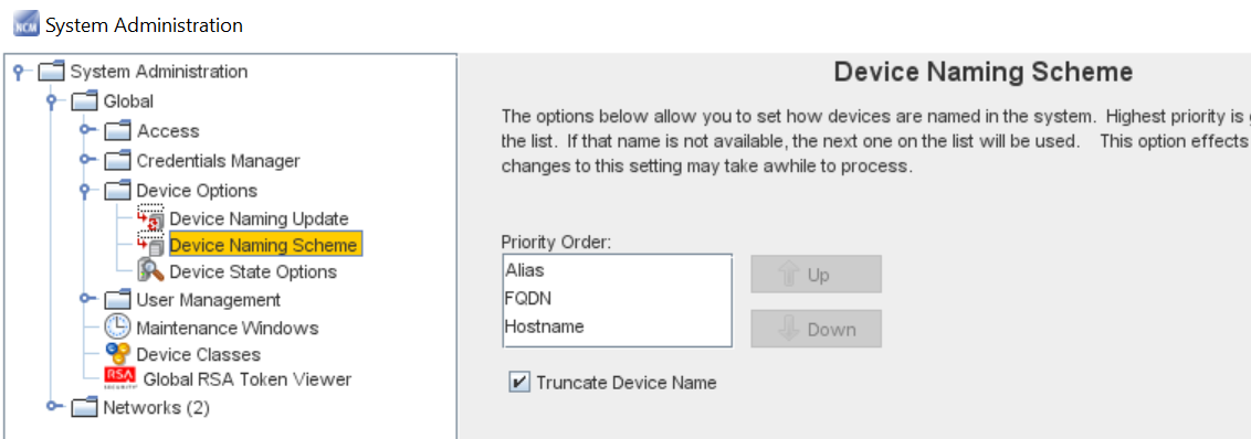

Smarts NCM has an option to use an alias column rather than device name. This column can be used to give the device an alias to identify the device.
If using the alias column does not deliver the desired result, the device must be rediscovered using SNMP or updated via a config pull including device identity. Ensure that naming update is set to "Always", see image:
  • SNMP pulls a specific OID value for hostname rather than relying on a regex match from the show version command.
  • Also ensure that the device IP resolves correctly though DNS as well as NAT address if applicable. Otherwise NCM will display the name the IP resolves to if SNMP is not used for discovery.
