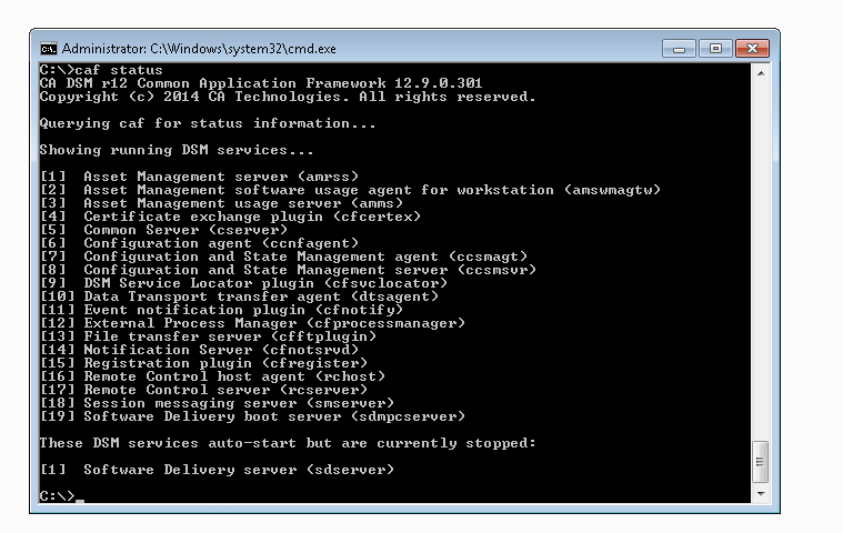

Jobs to agents downstream of a Scalability Server will not execute. A CAF STATUS reveals sdserver is stopped:
Running caf start sdserver only keeps it running for a few minutes and then it stops again.
