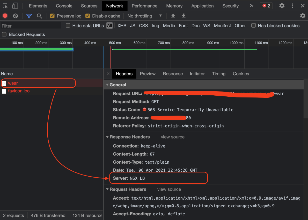

After administering a TKGI with an NSX-T based cluster, the application team started making use of Ingress for their application and one of the tests they run against the application, as well as the Kubernetes cluster, is to monitor the HTTP response headers when a client sends a request to the application. The tests reveal that when the client requested an API endpoint that does not exist on the Ingress resource or the Ingress resource does not have the rule to route the traffic correctly, then the following HTTP response headers are seen in the request:
As we can see from the previous screenshot, the browser (client) tried to access the application, specifically the /wear path (which we know that the application does not implement and the default backend also does not handle). If we take a closer look at the response headers, we see a field called Server that has a value of NSX LB. This might not be desirable from a security standpoint as internal details about the Load balancer are getting exposed to the end-user. The instructions section contains details on how to fix this.

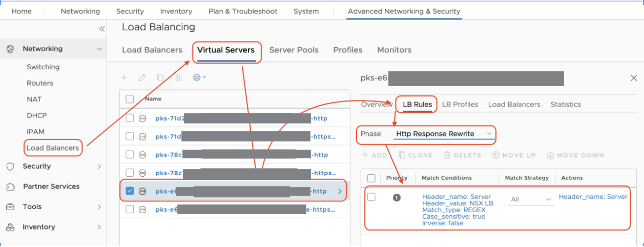

  • After the commands from the last step complete, you can verify in the NSX-T manager UI that the rule is present on the virtual server:
