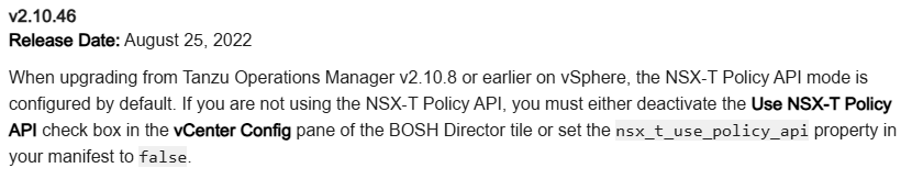

CAUSE:
A breaking change was introduced in Opsmanager, starting with version v2.10.46
This is mentioned in the 2.10.46 release notes
This is a breaking change starting with Opsmanager 2.10.46. Where the Director setting to use the NSX Policy API is enabled by default. This can break Concourse pipelines of earlier versions, because it was not a necessary parameter. Unless you are using the NSX-T Policy API, you will need to update your pipeline to set: nsx_t_use_policy_api: false
