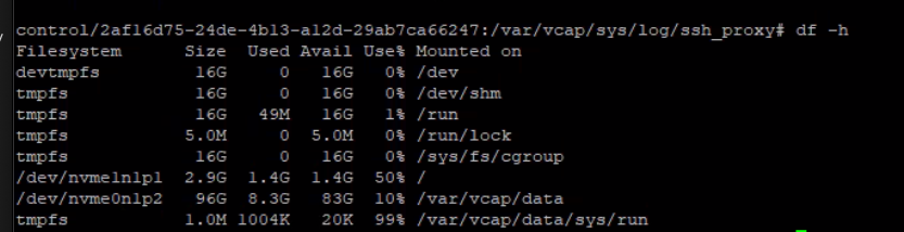

The partition, /var/vcap/data/sys/run, with size 1 MB is full.

The BOSH agent in certain lower Xenial stemcell versions mounts /var/vcap/data/sys/run as an 1 MB tmpfs. For Small Footprint TAS for VMs, there could be 50+ BOSH jobs colocated in a single VM. For example, 51 jobs in the control VM. The files to store container state would use up the 1 MB disk space under /var/vcap/data/sys/run.
