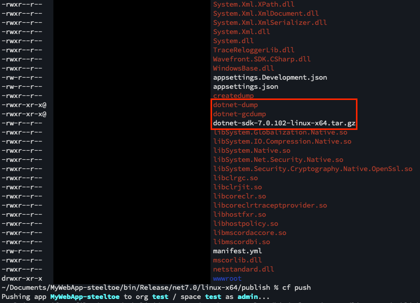

This process involves putting the dotnet tools on the app container and running it manually. If the app is self-contained (dotnet publish --self-contained true) you will also have to put the dotnet SDK on the app container to run the tools. You can either put the tools/sdk in the app root directory so it gets pushed with cf push or use scp to transfer the files to the container: https://docs.cloudfoundry.org/devguide/deploy-apps/ssh-apps.html#other-ssh-access
This below example is for a self contained app and uses cf push to get the files on the app container.
  1. Download and push the tools/sdk with the app
  2. SSH into the app container and extract the .NET SDK
    cf ssh MyWebApp-steeltoe
    mkdir dotnet-sdk && tar xvf dotnet-sdk-7.0.102-linux-x64.tar.gz -C dotnet-sdk

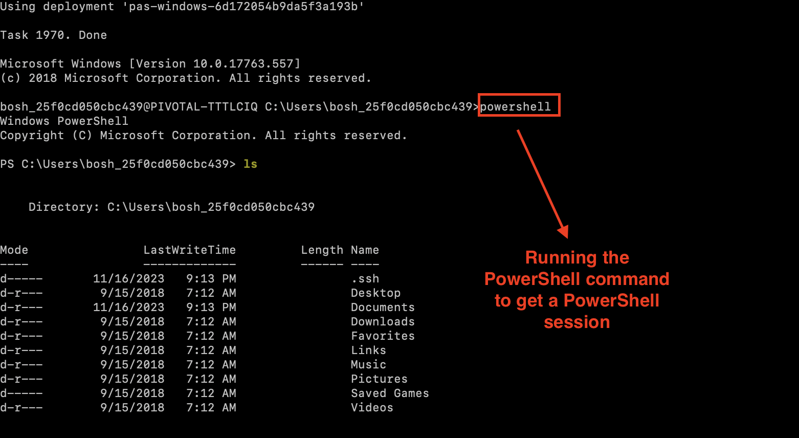

5. Start a PowerShell session on the Windows Diego Cell by typing powershell in the CMD command line:
powershell

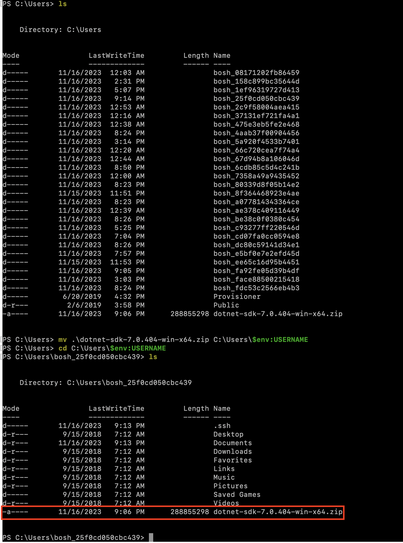

6. Move dotnet-sdk-7.0.404-win-x64.zip to the current Windows Diego Cell user’s home folder.
# Move to the user's directory where we SCP'ed this archive to
cd C:\Users
# Move this to the current user's folder
mv dotnet-sdk-7.0.404-win-x64.zip C:\Users\$env:USERNAME
# Change directories to current user's main folder
cd C:\Users\$env:USERNAME

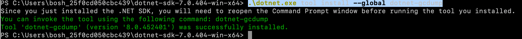

10. Using the dotnet.exe executable, we go ahead and download the dotnet-dump utility as well as the dotnet-gcdump utility with these following commands:
.\dotnet.exe tool install --global dotnet-dump
.\dotnet.exe tool install --global dotnet-gcdump

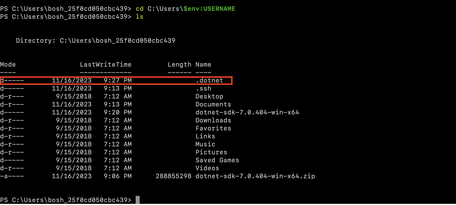

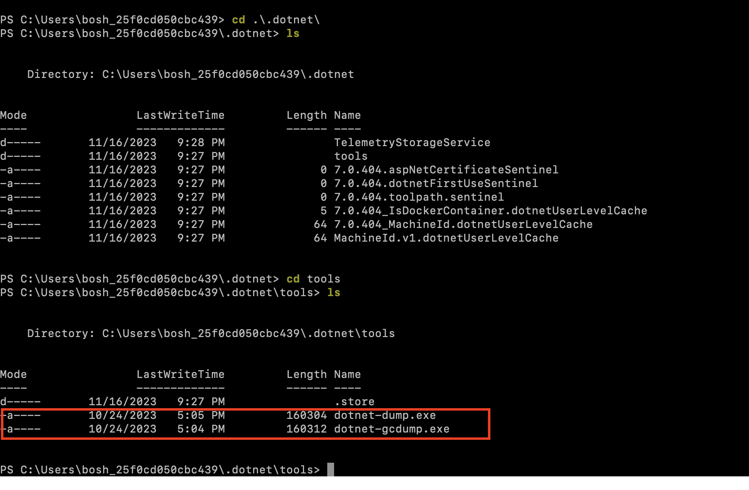

11. We navigate back to the current user’s home folder, and notice that a .dotnet folder has been created:
12. We navigate to C:\Users\$env:USERNAME\.dotnet\tools directory and we notice that dotnet-dump and dotnet-gcdump have been installed inside here:
cd C:\Users\$env:USERNAME\.dotnet\tools

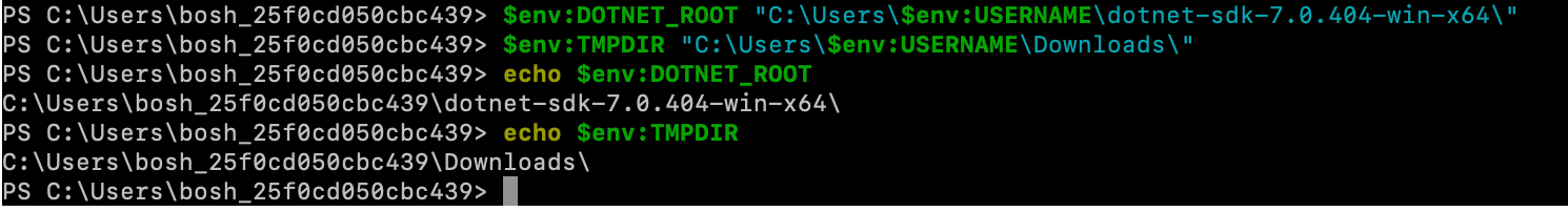

13. To use either of these heapdump binaries, we first need to set the Dotnet environment variables. We need to set the $env:DOTNET_ROOT environment variable as well as the $env:TMPDIR environment variable. For $env:DOTNET_ROOT we will set this to the location of our dotnet-sdk-7.0.404-win-x64 directory which in this case was C:\Users\$env:USERNAME. For the $env:TMDIR env variable, we can just set this to the user’s Downloads folder. We can set the environment variables as seen below:
$env:DOTNET_ROOT="C:\Users\$env:USERNAME\dotnet-sdk-7.0.404-win-x64\"
$env:TMPDIR="C:\Users\$env:USERNAME\Downloads\"
# We can confirm that the environment variables are properly set
echo $env:DOTNET_ROOT
echo $env:TMPDIR

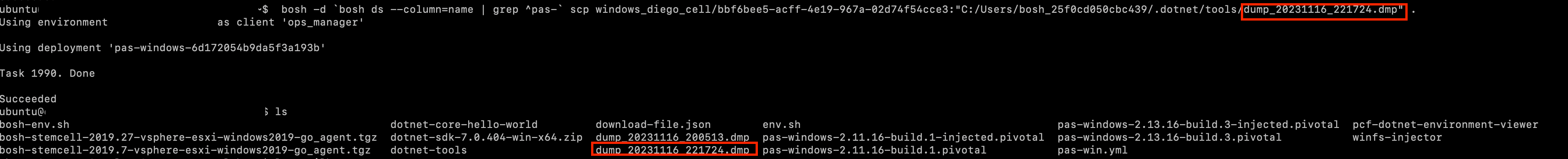

17. From here, we can analyze the dump in real time or transfer the dump back to the Ops Manager VM. For the option of transferring the heap dump file back to the Ops Manager VM, we can open a separate terminal, and execute the bosh scp command seen below:
# Transfer back to Ops Man VM
bosh -d <WINDOWS DEPLOYMENT NAME> scp windows_diego_cell/<Diego Cell ID>:"C:/Users/<Username>/.dotnet/tools/<Dump File Name>" .
# Analyze live
.\dotnet-dump.exe analyze <Heap Dump File>
.\dotnet-gcdump.exe analyze <Heap Dump File>
Transferring .dmp file back to Ops Man VM:
