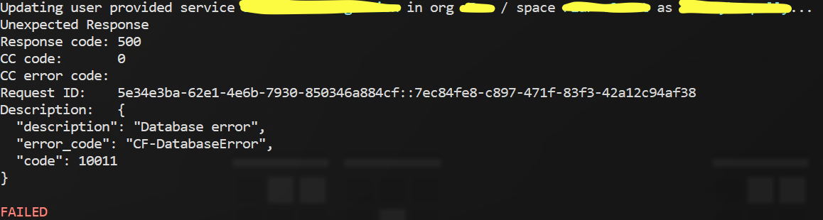

A user-provided service instance has many keys already. When updating this service instance to add more keys, it fails with CF-DatabaseError.
And the following messages are found in cloud_controller logs.
{"timestamp":1669010956.3045118,"message":"Request failed: 500: {\"description\"=>\"Database error\", \"error_code\"=>\"CF-DatabaseError\", \"code\"=>10011, \"test_mode_info\"=>{\"descr
iption\"=>\"Database error\", \"error_code\"=>\"CF-DatabaseError\", ......
{"timestamp":1669010956.3013282,"message":"exception not translated: Sequel::DatabaseError - Mysql2::Error: Data too long for column 'credentials' at row 1:\\n/var/vcap/data/packages/cl
oud_controller_ng/0f1c9a33a39a999c95bb313d3396932df2d7968a/gem_home/ruby/2.7.0/gems/mysql2-0.5.3/lib/mysql2/client.rb:131:in `_query' ......
