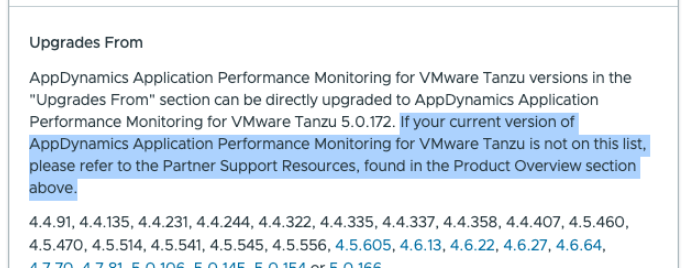

The permanent fix to the error “Could not install python: no match found for 3.6.x” in AppDynamics Platform tile is to upgrade to v5.0.477 as this version will update Python runtime of the dashboard generator to 3.7.x.
This compatibility issue is also a problem between newer versions of Elastic Application Runtime (v6.0.26) and AppDynamics 24.1.0-75. The tile metadata can be overridden as a temporary solution until updated tile is available.
