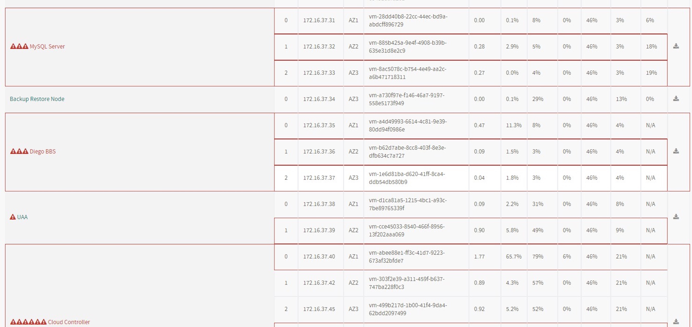

To bring up the MySQL cluster, follow the steps below to identify the MySQL instance with highest seqno and run a manual bootstrap.
IMPORTANT: You cannot bootstrap the cluster unless you have shut down the
mysqld process on all nodes in the cluster. For information on how to stop the
galera-init process for each node in the cluster, refer to
Shut Down MySQL.
1. Identify which node has the highest sequence number:
bosh -d <cf-deployment-name> ssh database -c "sudo cat /var/vcap/store/pxc-mysql/grastate.dat | grep 'seqno:'"
2. If all the seqno are positive,
ssh to the node with the highest seqno:
bosh -d <cf-deployment-name> ssh mysql/<database-with-highest-seq-no-id>
Then run this command:
echo -n "NEEDS_BOOTSTRAP" > /var/vcap/store/pxc-mysql/state.txt
If some of the the seqnos aren't positive, then try following the instructions covered in
Determine which Node to Bootstrap to recover the seqno.
3. Run the BOSH Ignore command for nodes with a lower seqno (you'll have to do this to 2 nodes).
bosh -d <cf-deployment-name> ignore mysql/<instance id>
4. Run the BOSH Start command on the remaining node with the highest seqno.
bosh -d <cf-deployment-name> start mysql/<instance id>
Note: this should create a 1 node cluster in a good state
5. Run the BOSH Unignore command on the 2 instances you ignored previously.
bosh -d <cf-deployment-name> unignore mysql/<instance id>
6. Run the BOSH Start command to start the CF deployment
Once the start finishes, TAS for VMs DB should be in a good state.
During the process of starting your CF deployment, if there are other VMs that still hit this issue, check if it can be resolved by recreating the VMs.
