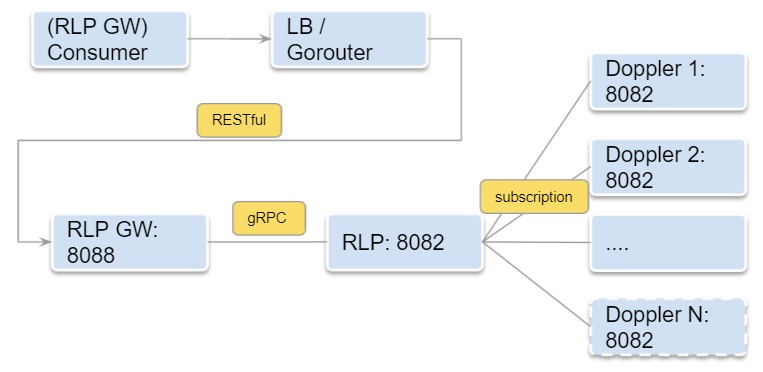

The below diagram helps visualize what is happening: The code shown above is the client, it is running in the box code called "Consumer". The log buffer is in the box called "RLP: 8082".
The Consumer reads the buffer by chunks of 10000 logs. If the buffer fills up faster than the Consumer can read chunks, to ensure not dropping the newest logs, the oldest unread chunk is discarded (dropped). On the next iteration, the Consumer sees that the sequence number on the next available chunk available (the buffer), is higher than the last sequence number he had completed reading. The code then raises an error warning about how many logs were missed during the read.
Exception occurred! Message: Missed Logs Details: 10000
To remediate the issue, the Consumer side should be scaled out. More Consumer instances should be able to prevent the log buffer from filling up.
