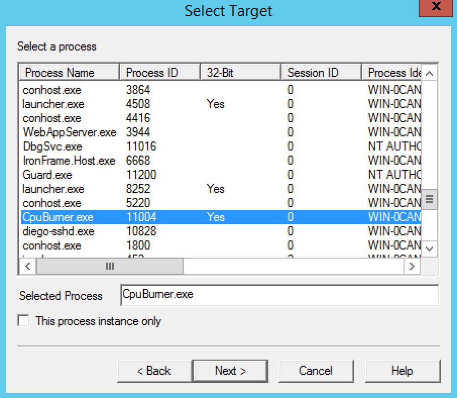

5. Using Task manager we can look up the process ID of the cpuburner app and make a note of it
6. Launch "DebugDiag 2 Collections" and use the crash wizard to start tracing the cpuburner process
​7. Then select to trace on a specific process
8. Select the CpuBurner.exe that matches the process id we found in taskmaster

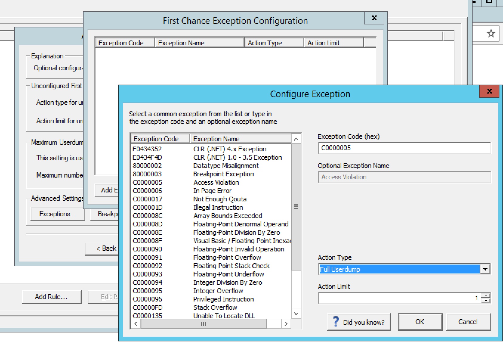

9. On the next prompt click Exceptions -> Add Exception and then populate the Configure Exception form to trigger the "Full Userdump" action when the Access Violation error code 0xc0000005 is encountered
10. DebugDiag will generate all core dumps and trace logs in the C:\Program Files\DebugDiag\Logs\Crash rule for all instances of CpuBurner.exe directory
11. Once the rule is activated you simply have to run steps to reproduce the fault or wait for the problem to resurface. The developer can use Microsoft tools to analyze the core dump and determine the root cause for the fault.
