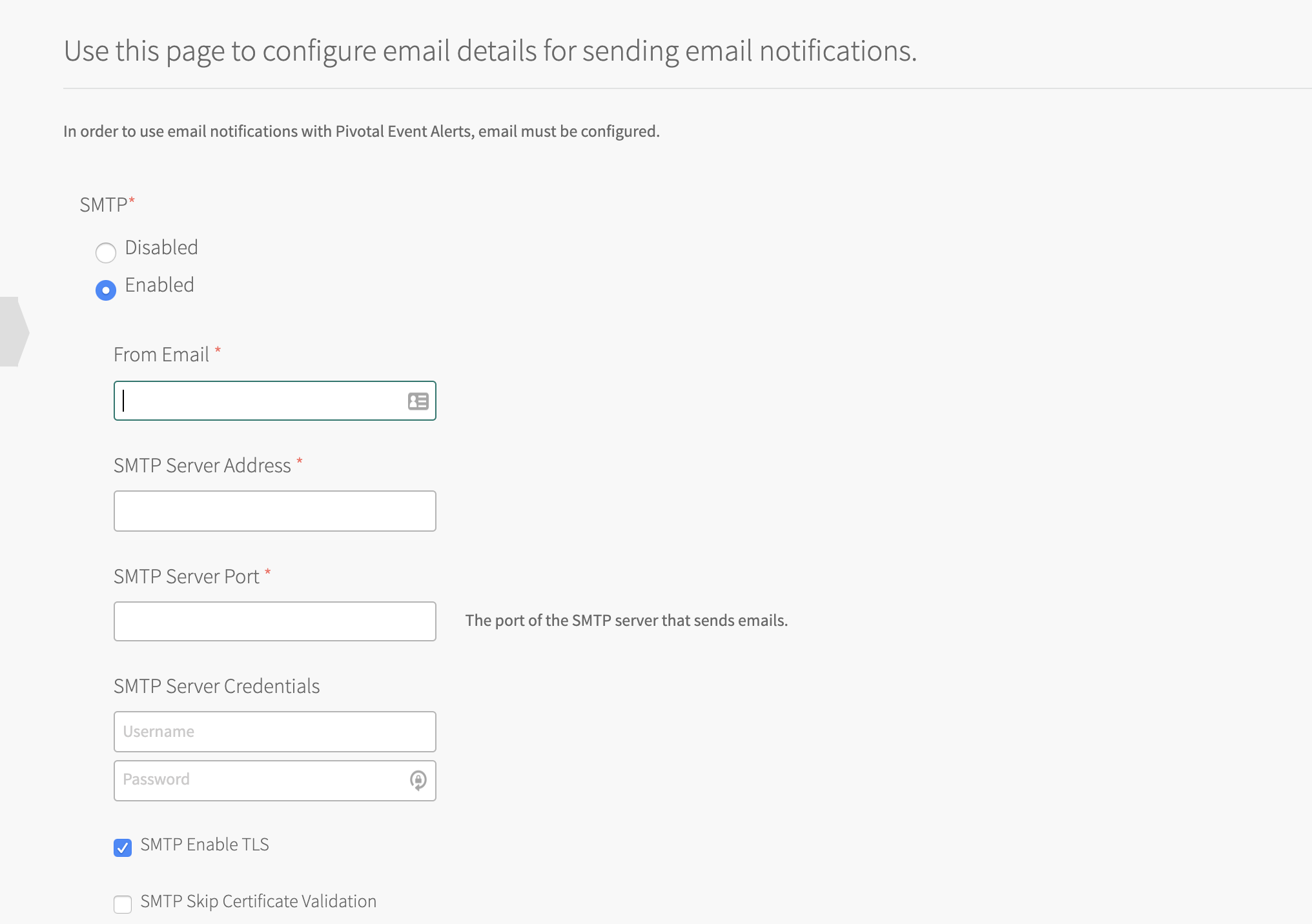

You are experiencing a server timeout issue when using the command below and you have configured Event Alerts to use SMTP and TLS.
cf eva-create-target mail-aptbox email test@testemail

For example, you have checked the "Enable TLS" box and configured port 465:

3. If you are still having issues, please make sure that your SMTP server is configured to use STARTTLS, and is not expecting a direct TLS/SSL connection to be used.
There are two different ways to encrypt communications when using SMTP:
a. The first is to connect over a plain text and issue the STARTTLS command. This will then upgrade your connection to use TLS and be secure.
b. The other option is to connect and directly negotiate a TLS connection, which wraps the entire connection in TLS, similar to HTTPS. STARTTLS is often done on ports 25, 587 or 2587. A TLS wrapper is often done on port 465.
Note: Using the TLS wrapper/port 465 is not supported with the Event Alerts tile. This is due to the underlying Golang net/smtp library's lack of support for this functionality. Your SMTP server must support STARTTLS and you must configure the Event Alerts tile to use a port which accepts STARTTLS.
