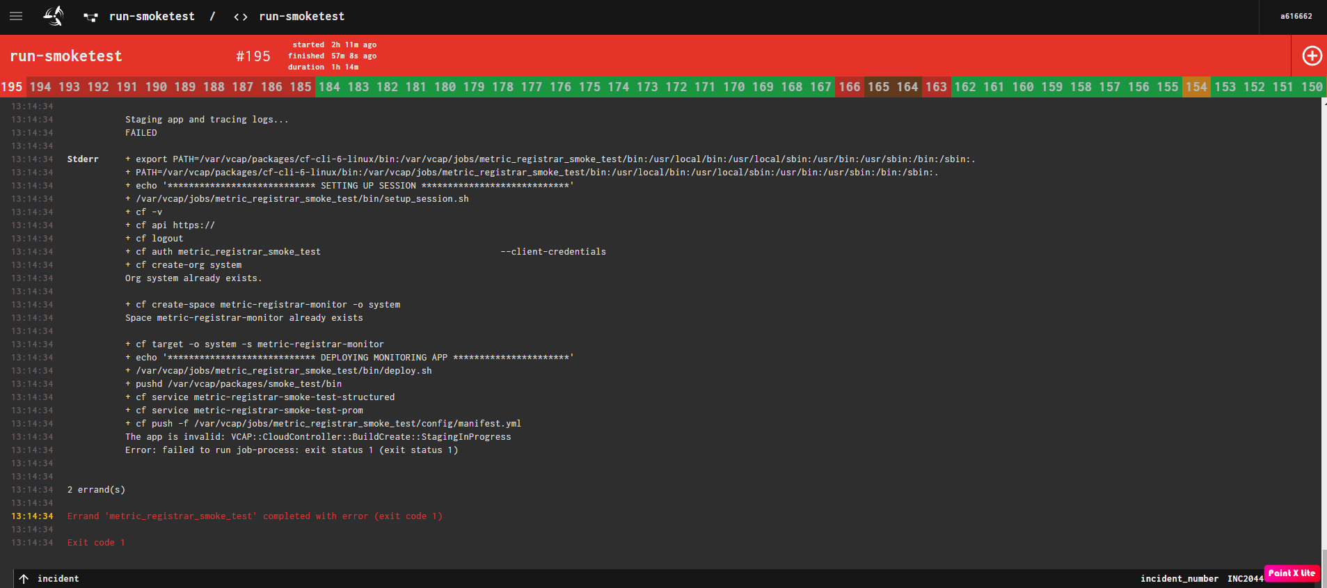

The error message depends on the errand that you run. This article will use the metric_registrar_smoke_test errand as an example. Below are some of the error messages reported on Concourse for VMware Tanzu:

+ echo '**************************** DEPLOYING MONITORING APP **********************'
+ /var/vcap/jobs/metric_registrar_smoke_test/bin/deploy.sh
+ pushd /var/vcap/packages/smoke_test/bin
+ delete-service metric-registrar-smoke-test-structured
+ cf service metric-registrar-smoke-test-structured
Service instance metric-registrar-smoke-test-structured not found
+ cf create-user-provided-service metric-registrar-smoke-test-structured -l structured-format://DogStatsD
Error: failed to run job-process: exit status 1 (exit status 1)
2 errand(s)
Errand 'metric_registrar_smoke_test' completed with error (exit code 1)
Exit code 1
