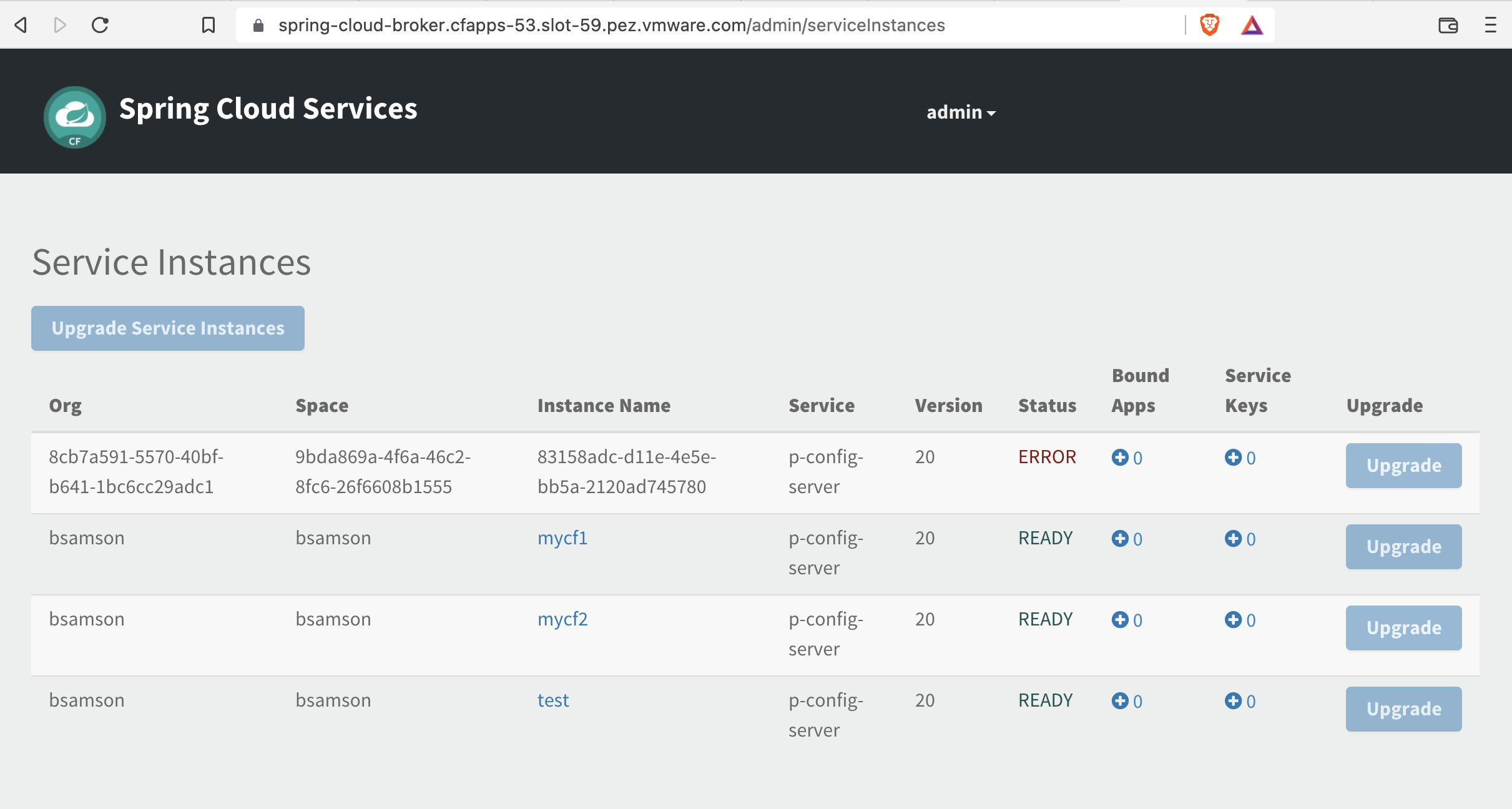

This article covers how to clean the bad service instance entries displayed on the Spring Cloud Service (SCS) 2.x Service Instances dashboard. The bad entries are showing the GUID for Org, Space, and Instance-Name columns because SCS is unable to resolve them as shown in the example below. The displayed GUID indicates that the SCS service no longer exists.
Product Version: 2.1
The following steps cover how to remove bad data from the database.
The example below will illustrate deletion of a record having Instance Name = '83158adc-d11e-4e5e-bb5a-2120ad745780'. This was taken from the <SCS_BROKER_URL>/admin/serviceInstances page (see above). The Instance Name is the same as the service_instance_id field, which is the GUID of the SCS service.

8. Verify the count from UI matches the number of records in service_instances.
mysql> select count(*) from service_instances;
For example:
| count(*) |
|        3 |
1 row in set (0.00 sec)
Refresh dashboard UI - the number of entries should match count. Repeat steps 1-8 as needed.
