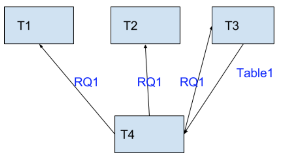

GPDB triggers a deadlock check process after a deadlock_timeout while waiting for a lock to be released by another process. A "wait-for" graph will be built for the involved running process. When there is a cycle in the graph, GPDB claimed a deadlock.
During the deadlock detection process, resource queue slot lock is also identified. The resource queue is waiting for any of the running processes. Some non-genuine deadlocks that might be detected are shown below:
For example, there are four concurrent transactions in one resource queue RQ1 with a three concurrency limit. T1, T2, T3 are running and T4 is pending. However, T4 already holds a table lock on table Table1 before it is pending in the resource queue.  When T3 runs a statement that expects a table lock on Table1, the following wait-for graph will be created:
Note: T3 and T4 are cycled to wait for locks. GPDB will think that there is one deadlock. However, this deadlock is a not a genuine deadlock and can be break when either T1 or T2 finish.
