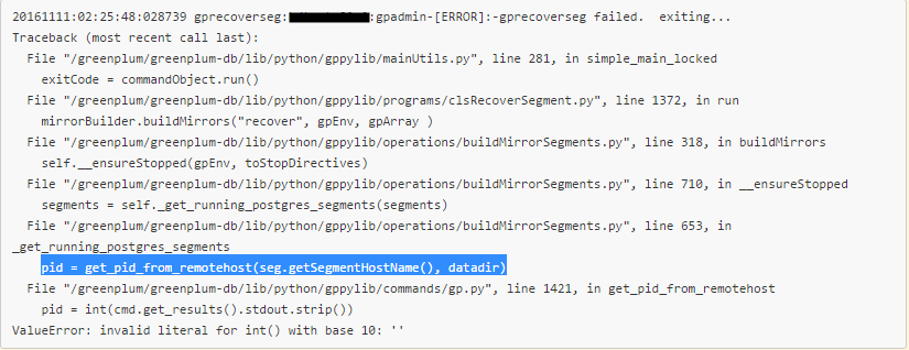

gprecoverseg with verbose fails with the error message "ValueError: Invalid Literal for int() with Base 10" and no specific/evident error seen on the master, primary and mirror logs:
When the database is restarted, gpstop throws a WARNING:
[WARNING]:-Unable to clean shared memory ('NoneType' object has no attribute 'rc')
As postmaster.pid file exists on a problematic segment, gprecoverseg is unable to complete the recovery operation. All the postgres related processes including the postmaster.pid file should be stopped/removed for the failed segment before it can go into the state of recovery.
