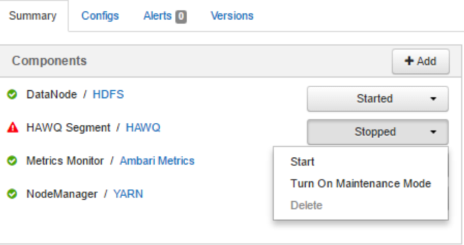

Ambari 2.4 UI presents the option to delete HAWQ services on segments. While deleting a HAWQ segment from a host, sometimes the DELETE option is grayed out and disabled as shown in the image below.
