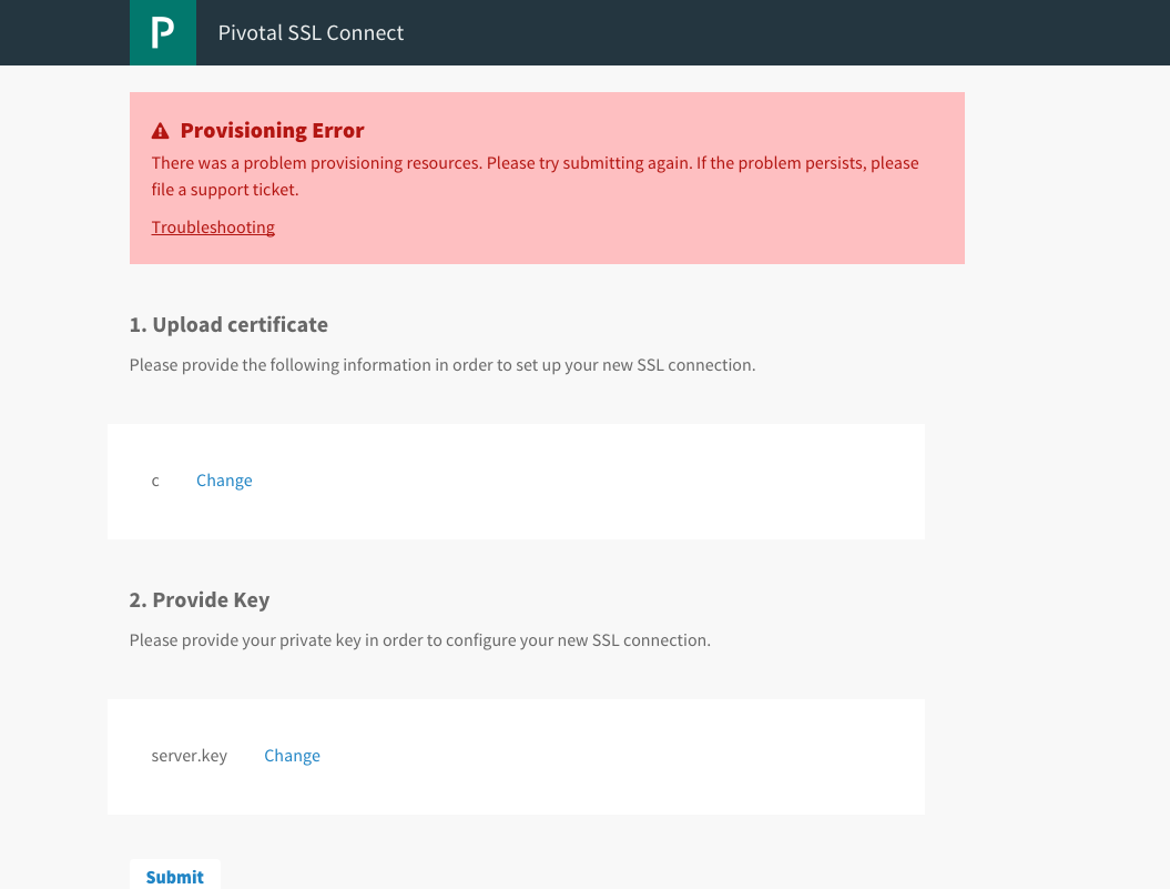

While trying to upload the SSL key and the certificate with the Pivotal SSL service, a Provisioning Error is seen as displayed in the screenshot below:
In the service instance logs, the following error appears:
Aug 02 10:09:03 SSL-Service b401ef18-3efd-4750-b8a3-98e42115dbc9/[APP/1]:  {"timestamp":"1470157743.573615074","source":"ssl-service","message":"ssl-service.service.ConfigureInstance.error","log_level":2,"data":{"error":"UploadServerCertificate: InvalidParameter: 1 validation errors:\n- field too short, minimum length 1: CertificateChain","instanceID":"08f1cb10-1420-40ff-8a27-814c76d22e15"}}
In the Pivotal SSL service, upload the entire certificate chain when filling in the Upload certificate field.
Obtain the intermediate chain files for the certificate from the certificate vendor. Combine these chain files with the certificate to create a single file containing the entire chain of trust. Then, upload it again. A correct certificate should look like this:
