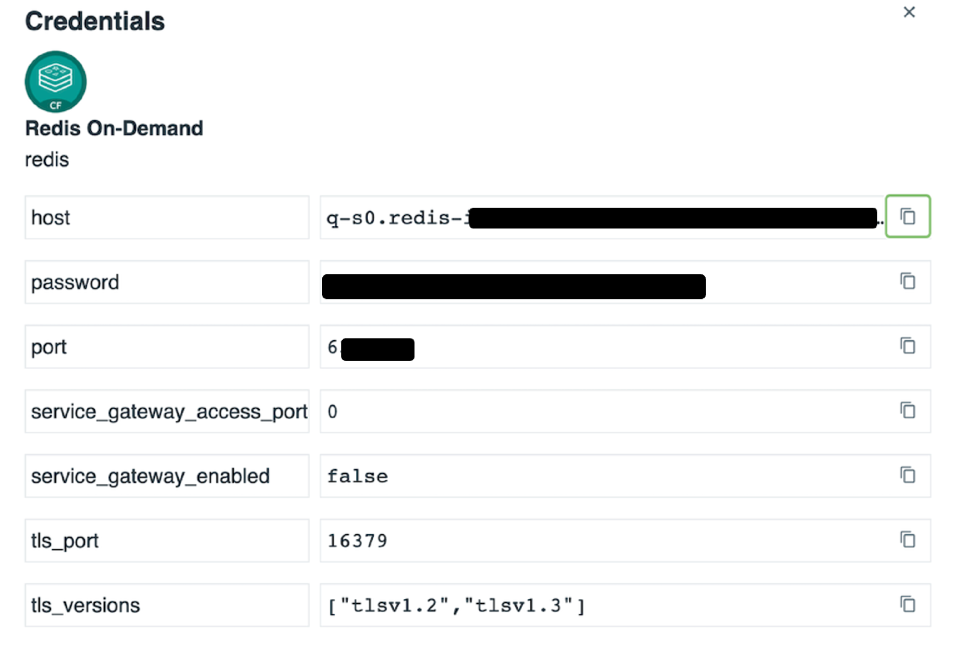

3. If you don't find any issue with Step 2. Check your app's credential to connect to a Redis Service Instance.
You can use cf env <spring-boot-app-name> or you can use apps manager UI. Check the credentials used to connect to Redis Service Instance, find tls_port and tls_version
if tls_port and tls_version are present, the Spring app will use TLS by default. This is also mentioned on our docs. You will need to configure your app to connect via TLS:
For spring boot 3.1.x
spring.data.redis.ssl.enabled=true
For spring boot prior to 3.1.x
spring.data.redis.ssl=true
you need to add this in your app's application.properties file. For more info, please see here .
