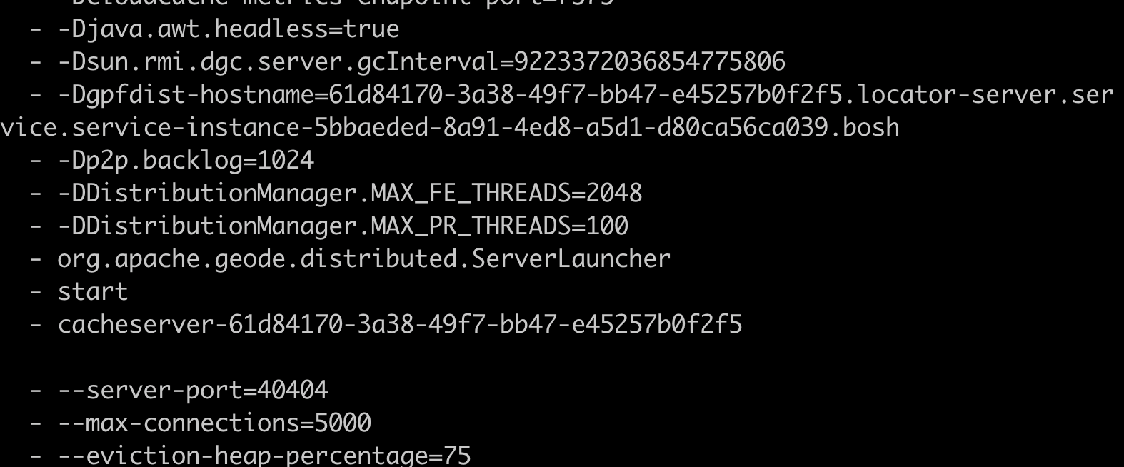

Below is an example and a screenshot of the kinds of configurations that can be added or changed:
   - -Dgemfire.security-manager=
  - -Dgemfire.security-enabled-components=server,http,jmx,gateway
  - -Dgemfire.launcher.registerSignalHandlers=true
  - -Dcloudcache-metrics-endpoint-port=7575
  - -Djava.awt.headless=true
  - -Dsun.rmi.dgc.server.gcInterval=9223372036854775806
  - -Dgpfdist-hostname=61d84170-3a38-49f7-bb47-e45257b0f2f5.locator-server.service.service-instance-5bbaeded-8a91-4ed8-a5d1-d80ca56ca039.bosh
  - -Dp2p.backlog=1024
  - -DDistributionManager.MAX_FE_THREADS=2048
  - -DDistributionManager.MAX_PR_THREADS=100
  - org.apache.geode.distributed.ServerLauncher
  - start
  - cacheserver-61d84170-3a38-49f7-bb47-e45257b0f2f5
  - --server-port=40404
  - --max-connections=5000
  - --eviction-heap-percentage=75

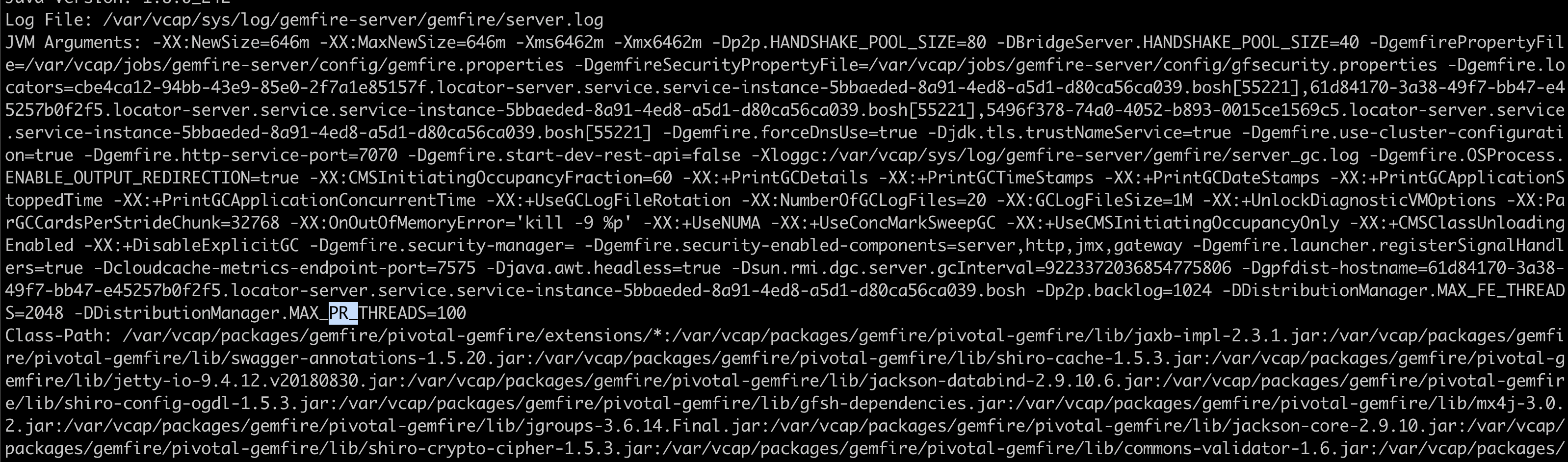

  • Then in the server.log (at /var/vcap/sys/log/gemfire-server/gemfire/server.log), the updated property will be shown as follows:

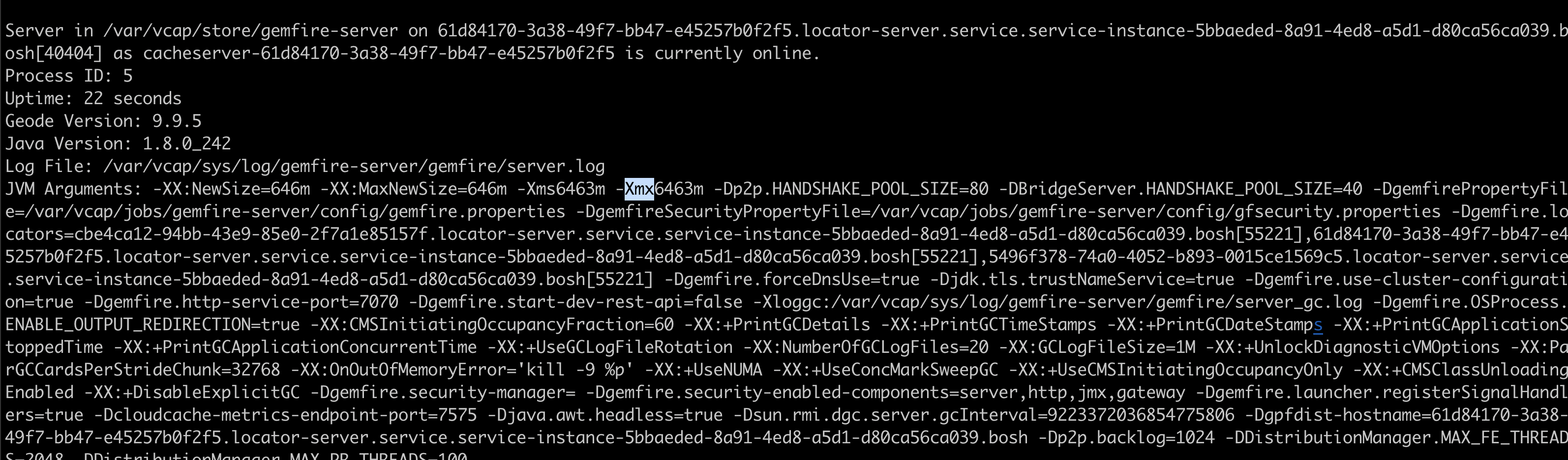

Below is an example and a screenshot of the kinds of configurations that can be added or changed using this method:
# JVM Xmx and Xms parameters now set in pre-start
cd /var/vcap/store/gemfire-server && \
exec java \
-XX:NewSize="$jvm_yg_mem"m \
-XX:MaxNewSize="$jvm_yg_mem"m \
-Xms6463m \
-Xmx6463m \
  • Monit restart all the VMs
monit restart all
  • Then in the server.log (at /var/vcap/sys/log/gemfire-server/gemfire/server.log), the updated property will be shown as follows:image.png
