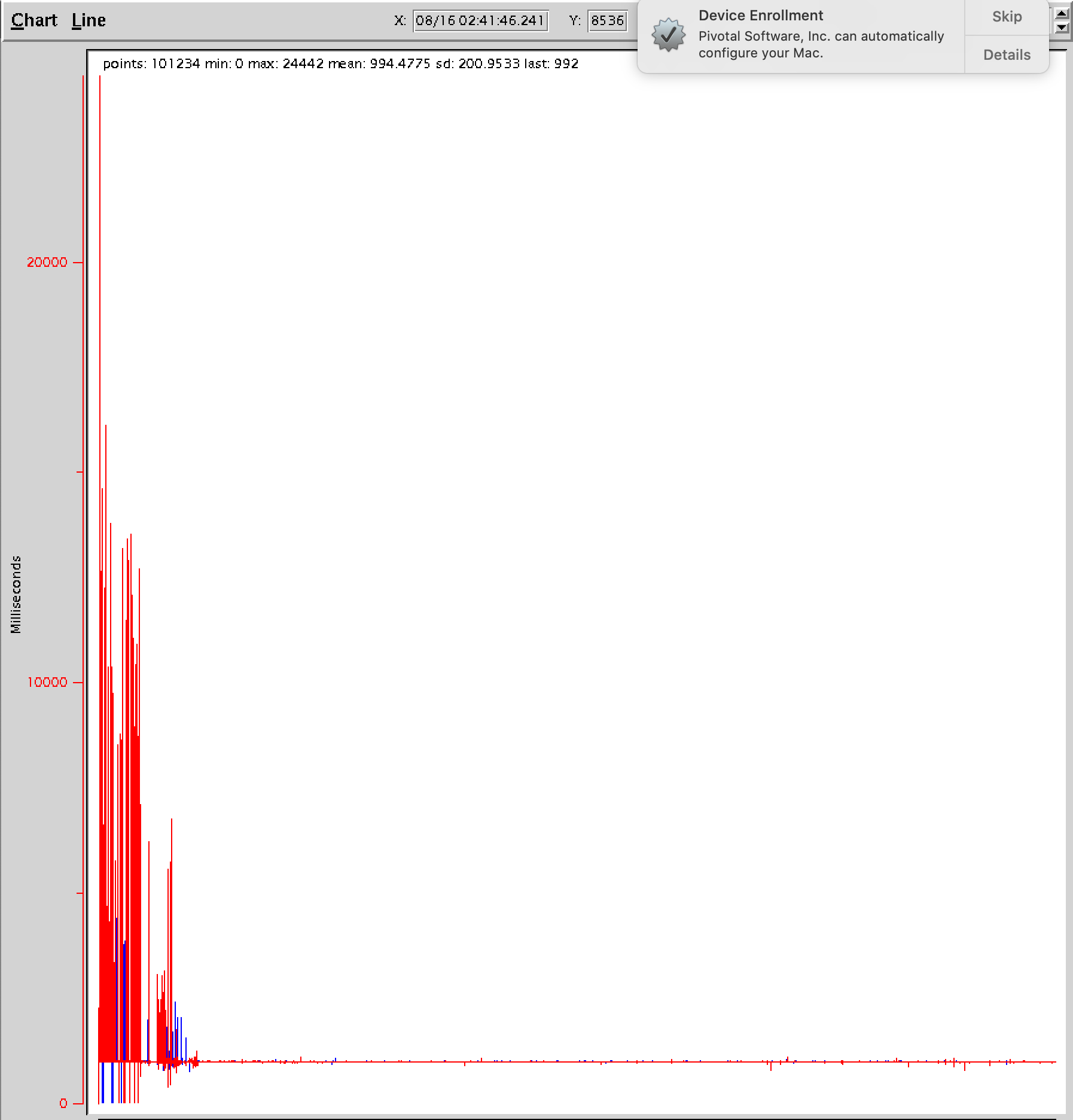

Below are a couple of charts illustrating how Survivor space, even when sized bigger, can still be insufficient when loading gigabytes of data in the GemFire cache.
You can see the Survivor space getting overwhelmed during the startup phase of a GemFire cache server given all of the data getting loaded. In the 2nd chart, you can see how this can negatively impact JVM Pauses, potentially causing startup issues.
