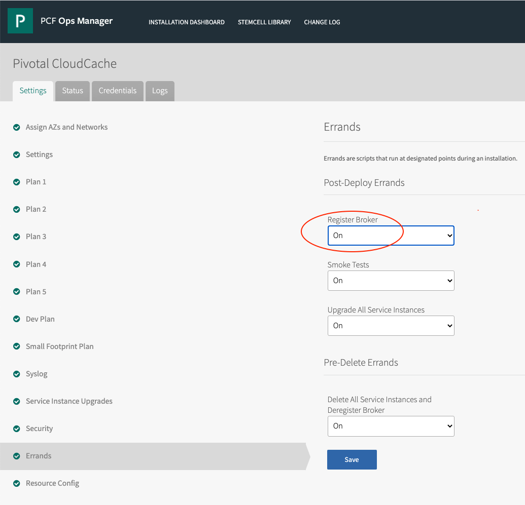

The best solution to fix this problem by avoiding manual intervention is to make sure to run Register Broker Errands on CC Tile > Settings > Errands and then Apply Changes.
These Errands by BOSH Director makes sure it refreshes the IP addresses or network settings for CC and registers in its database.
