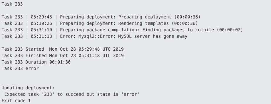

  • Apply change fails with "Mysql2::Error: MySQL server has gone away" error:
Task 233 debug logs shows the following UPDATE query to "deployments" database failed with MySQL server has gone away error:
E, [2019-10-28T05:31:18.087192 #4426] [task:233] ERROR -- DirectorJobRunner: Mysql2::Error: MySQL server has gone away: (conn: 47089563510420) UPDATE `deployments` SET `name` = 'cf',
`manifest` = '---\naddons: []\ninstance_groups:\n- azs:\n  - us-west-1a\n  - us-west-1b\n  env:\n    bosh:\n      password: \"$6$5ee878bd422106b9$EOpyR7AsPPZcGsCvRY0N8xdnYC5IPeI5dL6ojqHaZK/FFyPriPApF9lJBLtB9uUxa9ZP/rruNotVuY36cBuVE/\"\n  instances: 0\n  jobs:\n  - consumes: {}\n    name: loggregator_agent\n    properties:\n      loggregator:\n        tls:\n          agent:\n            cert: \"((/opsmgr/cf/doppler/metron_tls_cert.cert_pem))\"\n            key: \"((/opsmgr/cf/doppler/metron_tls_cert.private_key_pem))\"\n          ca_cert: <BIG CHUNK OF DATA>

  • The default max_allowed_packet size is 4MB based on this doc: Best Practices for configuring parameters for Amazon RDS for MySQL
  • 2019 Certificate bundle which was added in Bosh and TAS configurations sent an UPDATE query from Director to deployments database residing in RDS with a packet size which was > 4MB
  • This resulted in RDS not being able to process the UPDATE query and thus "MySQL Server has gone away" error.
  • To resolve this issue, modify the parameter group in Amazon RDS which is used for each database instance that Bosh or TAS external databases know about. (Amazon RDS -> DB instances -> Click DB name/identifier -> Configuration tab -> Parameter group -> Click parameter group name -> Edit Parameters -> Edit max_allowed_packet with a value in bytes (Eg. Recommendation - 64000000 bytes(64MB))
  • Save changes, wait for the modification to propagate properly.
  • Reboot the RDS instance (Amazon RDS -> DB instances -> Select DB name -> Click Actions dropdown -> Select Reboot)
  • Wait for the reboot to complete and then run the Apply Changes
