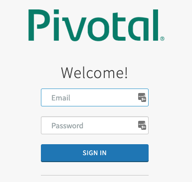

After clicking the Setup Authentication button and being presented with the following screen:
You tried entering LDAP credentials for a user multiple times and received the follow error:

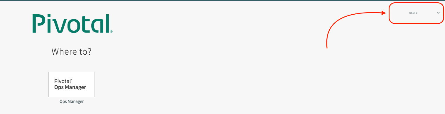

When clicked on the UAA link presented on the page above, you will see this:
Based on the above screenshot, you can see that the user is authenticated. This error however "You do not have sufficient privileges to view this page" means that our LDAP user does not have correct Role(s) assigned to it.
