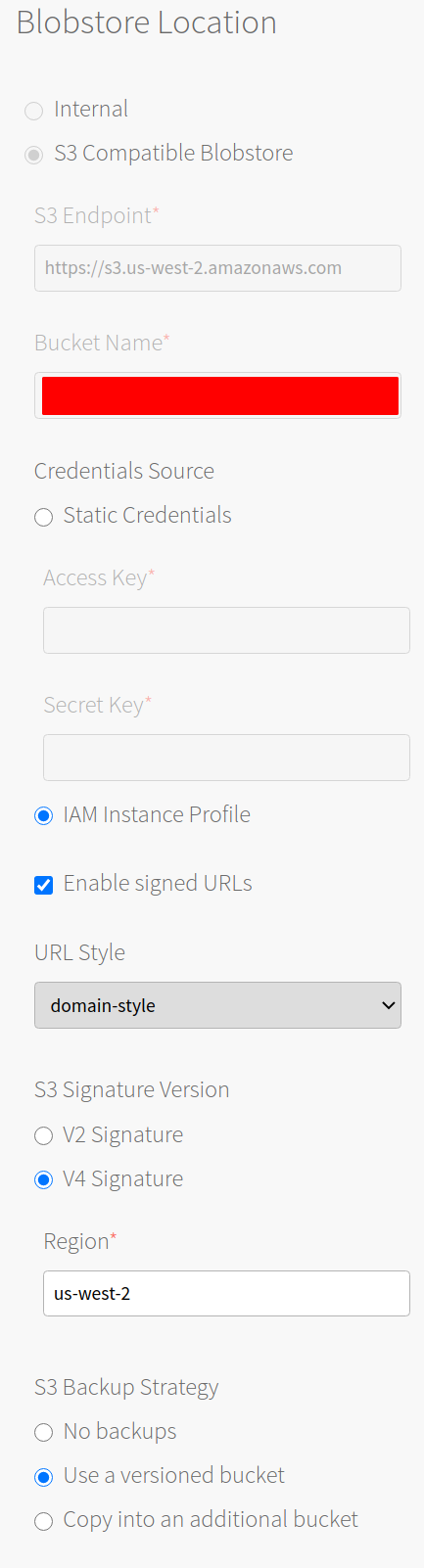

An error occurs when backing up a Bosh Director using a Bosh Backup and Restore (BBR) that is configured to use S3 buckets as the Blobstore destination and IAM Instances profiles for authentication, as shown below:

The issue has to do with the fact that the operator chose IAM instance profile over static credentials (aws_access_key and secret_key) for authentication. As it stands, the support for IAM instance profiles when running a BBR is hardcoded to false, forcing access to be done by static credentials only.
'use_iam_profile' => false

As a workaround, the operator can hardcode the buckets.json file so that the flag use_iam_profile is set to true.
  • SSH to the bosh director
  • Switch to root
  • Edit (vim/nano) the file /var/vcap/jobs/s3-versioned-blobstore-backup-restorer/config/buckets.json
{"director-blobstore": {"aws_access_key_id":null, "aws_secret_access_key":null, "endpoint":"https://s3.us-west-2.amazonaws.com", "name":"<BUCKET_NAME>", "region":"us-west-2", "use_iam_profile":false, "force_path_style":false}}
  • Change the value of use_iam_profile to true.
