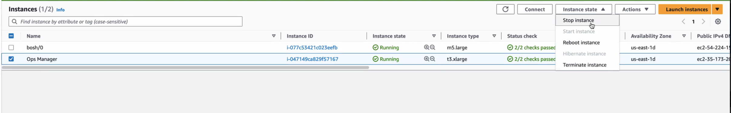

Solution 1: Restart the OpsMan VM from the IaaS console. (AWS)
Note: You need to make sure to have the OpsMan Decryption Passphrase available before you start this process.
  • Access the IaaS console and find the OpsMan VM.
  • Restart the VM. There are two options to do this:
    • Select the Stop Instance and then the Start Instance options.
    • Use the Reboot Instance option
  • Access the OpsManager UI. The first time accessing it after restart it will request the Decryption Passphrase before loading the login page.
  • Login to OpsMan and retry the Apply Changes process, the time should be back in sync and the credentials validated without issues.
