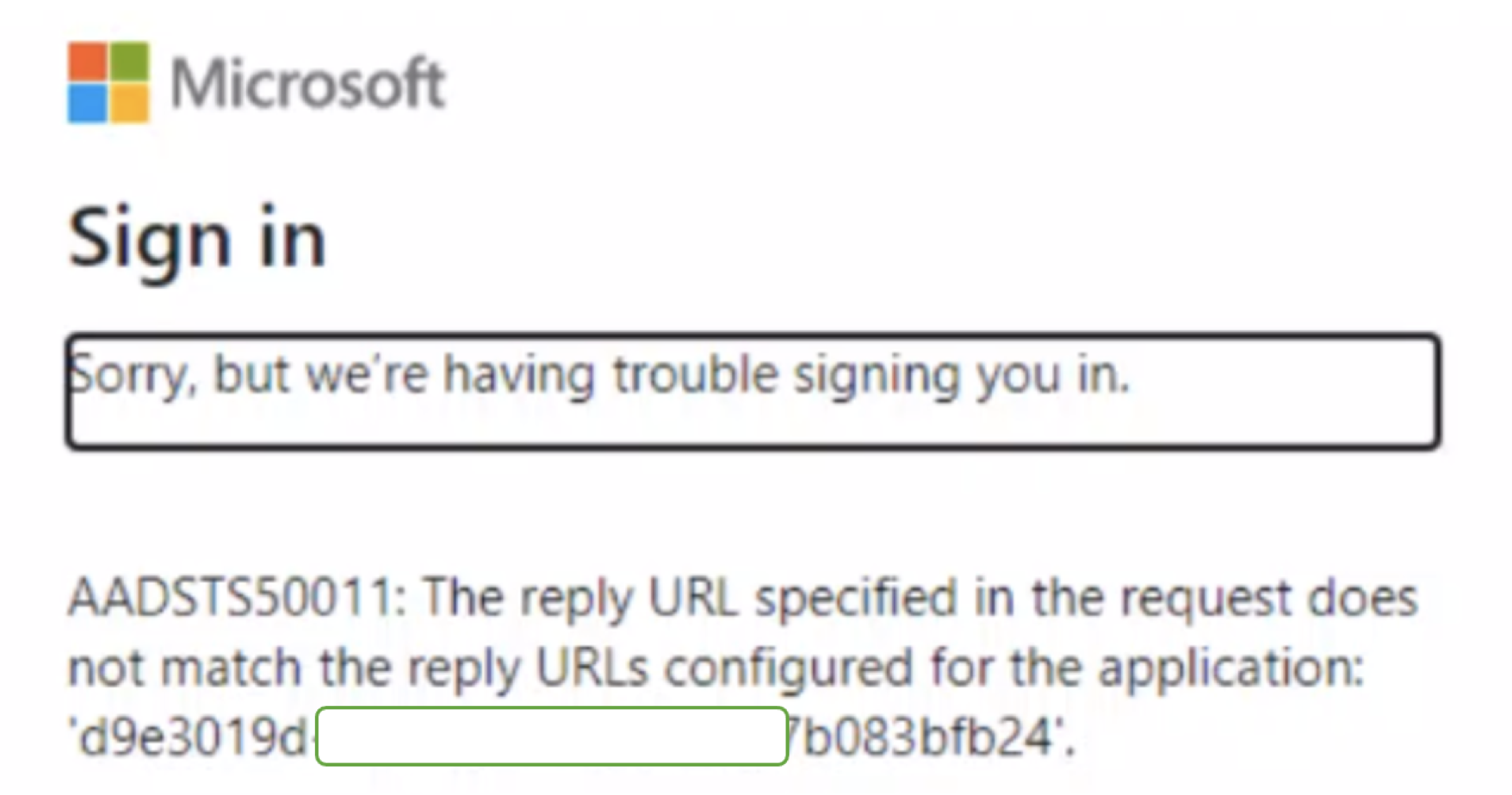

Upon providing the correct account credentials, you see an error message similar to the following:
AADSTS50011: The reply URL specified in the request does not match the reply URLs configured for the application: '<Application-ID>'
This issue happens when the application registered with Azure AD does not know where to respond back because the redirect_uri in the incoming request does not match the reply URL (or redirect URI) configured on the application registered with Azure AD.
In your web browser, the error is presented like this:
Behind the scenes, the request sent by the application (incoming request) looks something like this:

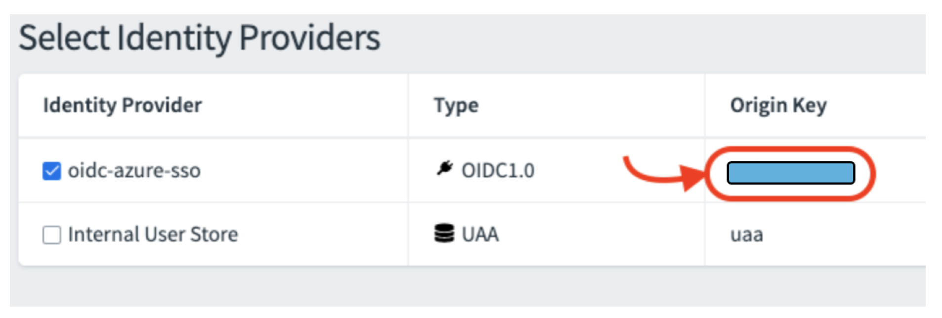

In the incoming request, the ORIGIN-KEY is set to ############ (without any dashes) but in the above screenshots the ORIGIN-KEY is set to ####-#####-#### (with dashes)

  • ORIGIN-KEY - Can be found on the SSO Developer Dashboard. In Apps Manager > go to the org and space where the service instance for SSO resides > Open the service by clicking on its name > Click the Manage button to open the SSO Developer Dashboard.
The following screenshot is from the SSO Developer Dashboard showing the active Identity Provider on the service instance and the name of the ORIGIN-KEY:
Please make sure to look up the value in the dashboard, as it's not always the same as the Identity Provider name, for example, dash characters are stripped out.
