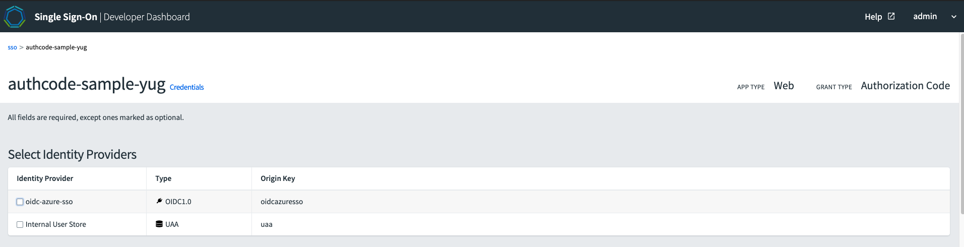

After the rebind operation succeeds, an application gets registered within SSO and can be found by navigating to the Developer dashboard. When you click on the registered application to view its configurations, you will find out the Identity Providers configured for that application are all unchecked. This is what causes the behavior explained above. When the external Identity Provider is left unchecked, the application request gets redirected to UAA and UAA does not know what authentication method to show because none of the available identity providers is enabled.
For example, Navigate to the SSO Developer dashboard by going to Apps Manager > Org & Space of where the application exists > Click the application name > Go to Services > Click on the SSO service instance bound to the application > Manage. This will open the Developer dashboard - click on the App Name. You will then be able to see that the Select Identity Providers section shows internal as well as external Identity Providers that are configured to use but none of them are selected. Here is a screenshot from a lab environment that shows the same:

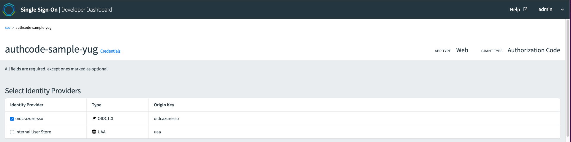

Enable the one that your use-case requires and update the app by clicking the Update App button at the bottom of the page. Here is how this will look:
Now you can open the application in the web browser again and you should be redirected to the external identity provider.
