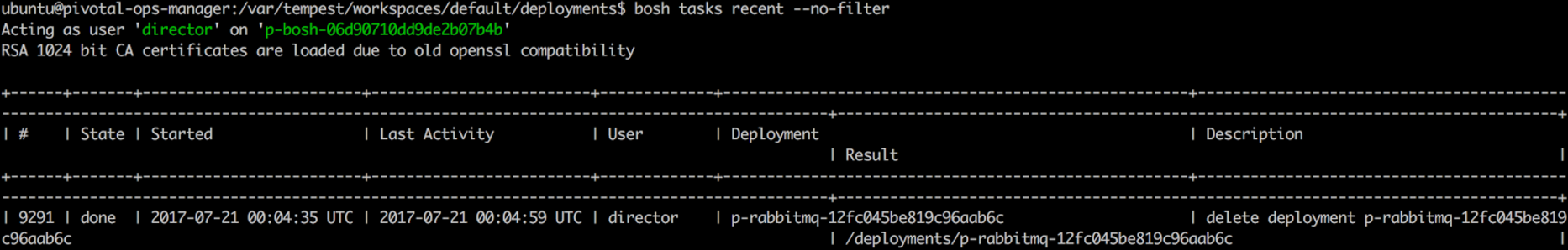

`bosh tasks recent --no-filter` will list the recent tasks. By default, Bosh will only store 100 recent tasks in its database.
Make sure you see the delete deployment task as below

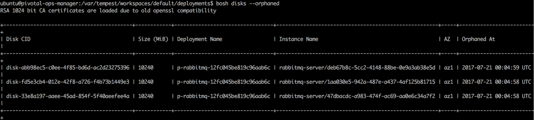

Execute `bosh disks --orphaned` and see the persistent disks for the deleted deployment are still listed as orphaned disks
Note: If you do not see any orphaned disks then the persistent data has been deleted, and it's not possible to restore the deleted deployment. In this case, this KB is not applicable to your use case, so you would need to reinstall the missing tile and restore your data from a backup.
Now identify the right VM’s to which these disks were attached; follow the below process.

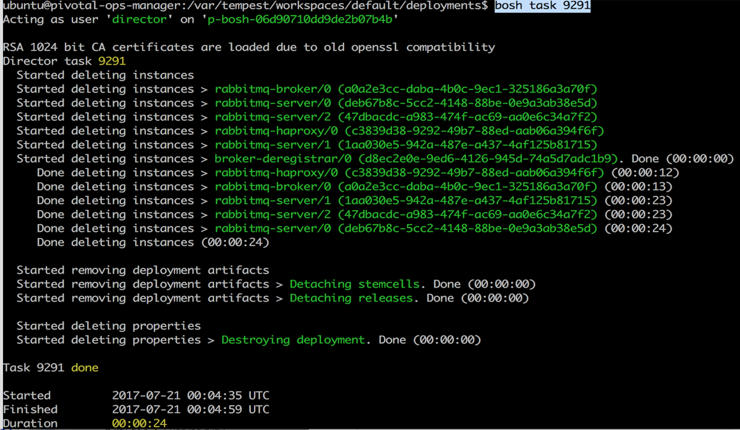

Execute `bosh task <task-number>`, where `<task-number>` is the task number from step #1.  In our example, it’s `bosh task 9291`, which will list the deleted VM id's like below
Step 4
Comparing the GUID from the **Instance Name** from `Step 2` output and `Step 3,` make a list of the corresponding VM and disk mappings.
In this scenario, the following is the VM-Disk mapping
       VM Disk ID
rabbitmq-server/0 -- disk-abb98ec5-c0ee-4f85-bd6d-ac2d23275396
rabbitmq-server/1 -- disk-fd5e3cb4-012e-42f8-a726-f4b73b1449e3
rabbitmq-server/2 -- disk-33e8a197-aaee-45ad-854f-5f40aeefee4a

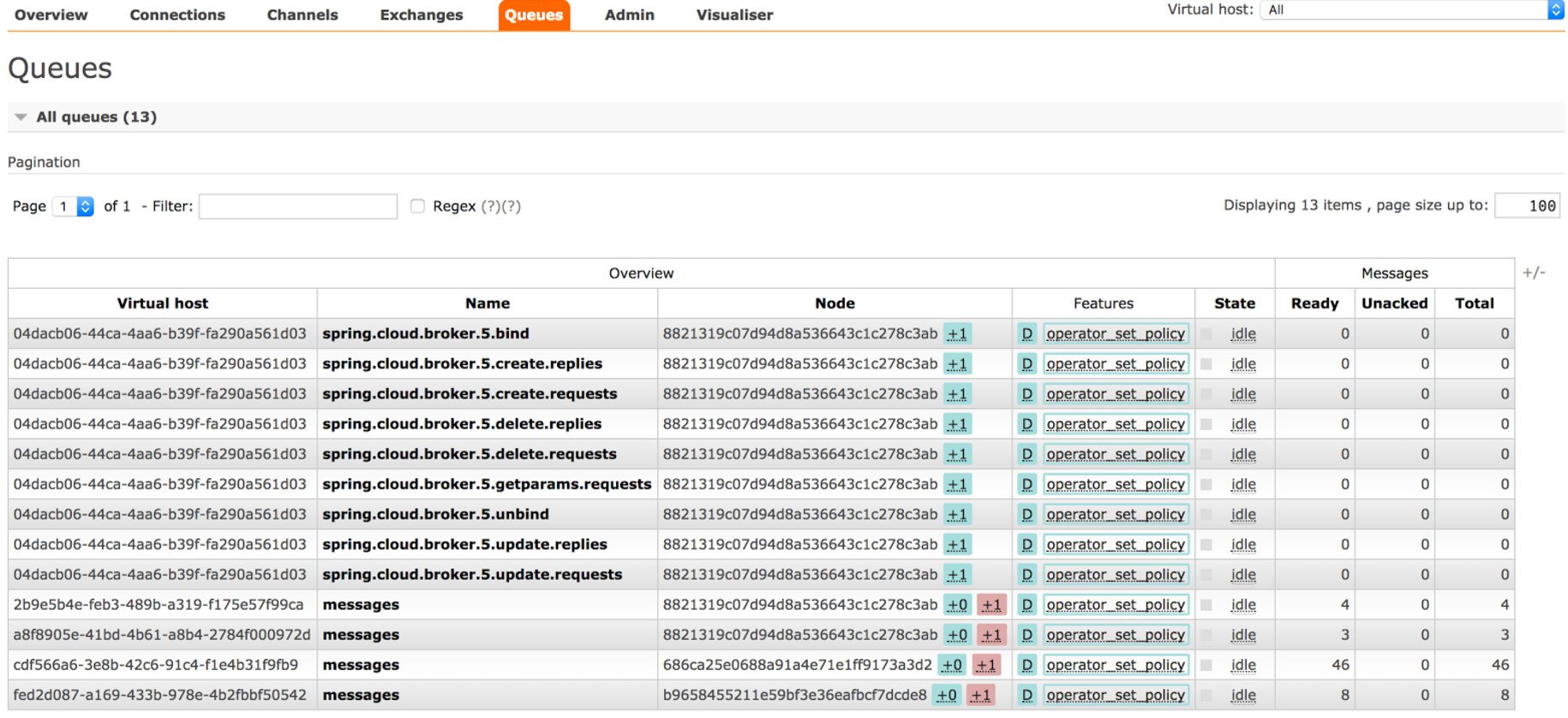

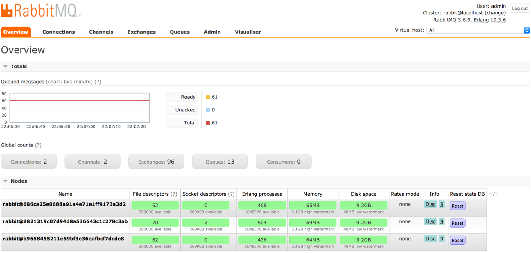

You should now see all the data as the original. The example scenario all the queues are active including unconsumed messages in the queues and the application, which is being used for testing so we can confirm that apps were able to consume the messages from its queue.
