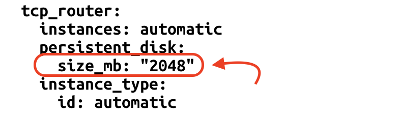

pas-staged-config.yml and look for "tcp_router" under the resource-config section. You will see something similar to this:om -u <user> -p <password> -t <ops-manager-url-endpoint> -k configure-product --config pas-staged-config.yml6. The above command will produce the following error:
staged-config command, a GET request is made to the Ops Manager API across the following endpoint /api/v0/staged/products/:product_guid/jobs/:job_guid/resource_config. Next, when you run the configure-product command, a PUT request was made to put the response back or start configuring the PAS tile.configurable" is checked in tile metadata for the TCP Router job. The following snippet shows this metadata:configurable" is set to "false" in this case, you are restricted from modifying this value and hence the error is produced.

Note: If you are trying to update the value of the tcp_router size_mb property in pas-staged-config.yml from a custom value, such as "2048" to automatic, you will be able to get past this error but at the same time you will get a behavior that is not desired.
For example:
configure-product now, an error will be thrown.configure-product command again. The command is successful this time, but will end up changing the value to "Automatic: 1GB". This should be visible in the PAS tile UI itself after successful execution of the configure-product command, which is not desirable if you are planning to keep the size at 2GB.
