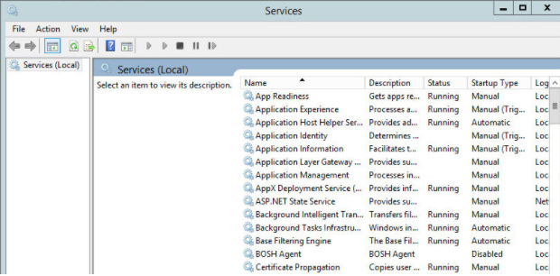

Step 2: Console into your VM through you IaaS
Login into the Windows VM with your credentials used to create the Stemcell.
Step 3. Go to the "Start" menu and then to the Task Manager
Step 4. On the "Services" tab, sort by Name: BOSH Agent. Note it is stopped.
Step 5. Right click on BOSH Agent, select "Open Services".
Step 6. On the Services window, you can see that the BOSH Agent is set to Disabled by default.
Step 7. Right-click on the BOSH Agent, and click "Properties".
Step 8. Change the startup type to "Manual', click "Apply". Windows updates the BOSH Agent.
Step 9. Click "Start". The BOSH Agent starts.
