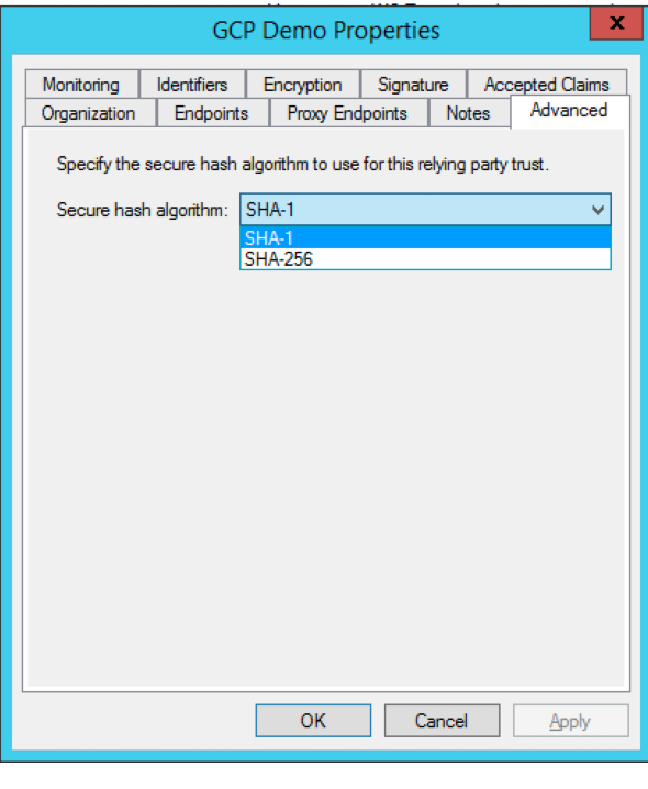

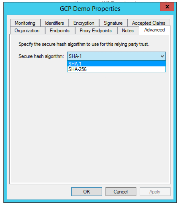

- Change your Identity Provider’s expected SAML signature algorithm to the SAML Signature Algorithm that you are using for PAS (SHA256 or SHA512)
- For ADFS, the option looks like the picture below:

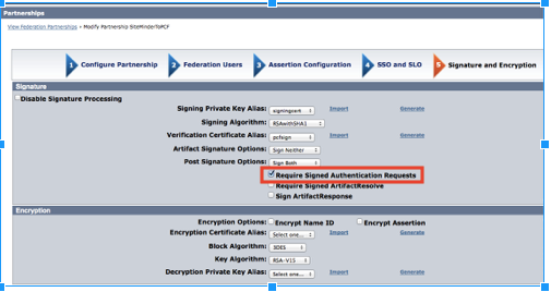

- For CA Siteminder, the option looks like the picture below:

- Change your Identity Provider’s expected SAML signature algorithm to the SAML Signature Algorithm you are using for PAS (SHA256 or SHA512).
- For ADFS, the option looks like below:
- For CA Siteminder, the option looks like below:

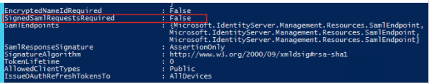

- If your Identity Provider is still attempting to validate the signature even though none is being sent, you can disable validation of signed authentication requests in your Identity Provider’s configurations.
- For ADFS, this is managed through the
`Set-AdfsRelyingPartyTrust -TargetName "<Relying Party Trust Name>" -SignedSamlRequestsRequired $false` command. You can view the current settings with `Get-AdfsRelyingPartyTrust -Name "<Relying Party Trust Name>"`
- For CA Siteminder, you can uncheck “Required Signed Authentication Requests” for the applicable partnership.
