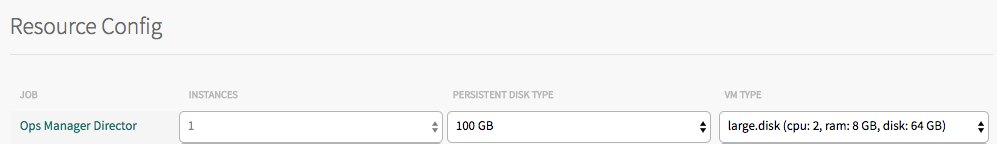

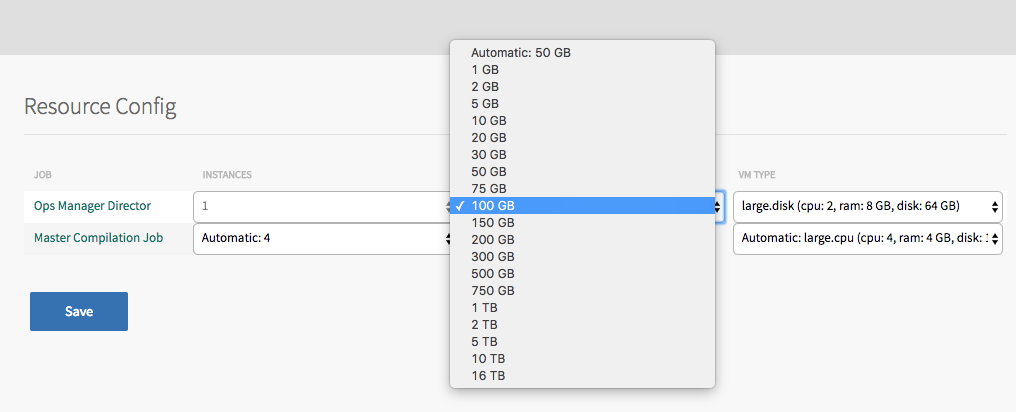

To check current persistent disk usage, select the Operations Manager Director tile from the Installation Dashboard. Select Status and review the value of the PERS. DISK column. If persistent disk usage is higher than 50%, select Settings and Resource Config, and increase your persistent disk space to handle the size of the resources. If you do not know how much disk space to allocate, set the value to at least 100 GB.
1. Go to "Operations Manager Director Tile and then to Resource Config". See below:
2. See the memory that is the Persistent Disk Type. You need to increase the disk space based on your requirement.
