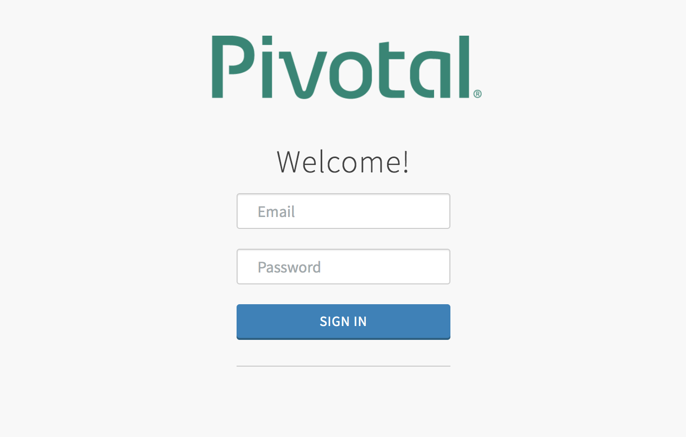

When user tries to log into the Metrics UI with valid login information, the user is redirected back to the login page. It doesn't matter how many times you log in the user is continuously forced back to the login page.

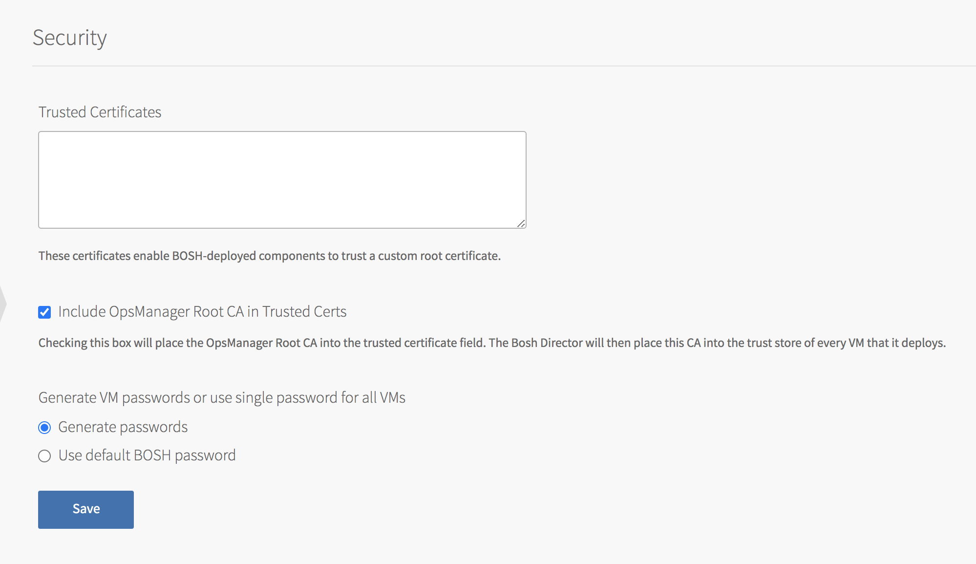

  2. Check that you have added any required Root CA's have been define in the Bosh director under the security section and that you have checked to include the OpsMan root certificate on all the vm's:
