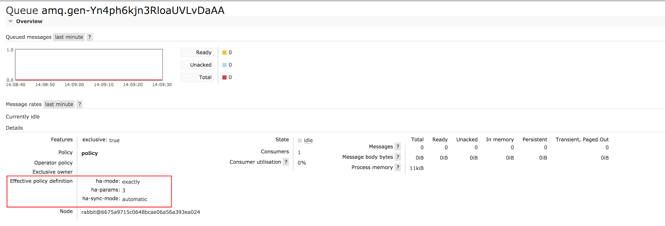

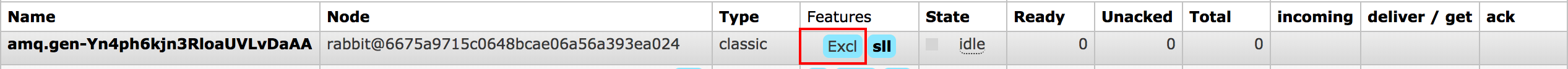

If all nodes are up and running, check if the queue name mentioned in the pre-start logs on the Management UI is an exclusive queue.
If it is an exclusive queue, next check if a mirroring policy has been applied to it. You can do this by clicking on the queue name, and checking the Effective policy definition section.
In the above example, the queue is expected to be mirrored to other nodes. However, exclusive queue are not mirrored by design [1]. This causes the pre-start script to fail. This behaviour will be changed in a future release of RabbitMQ [2].
