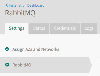

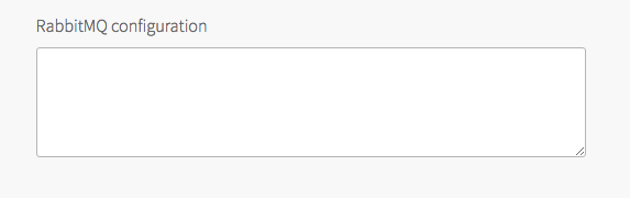

In order to change that setting, it’s possible to do so via Operations (Ops) Manager using the RabbitMQ configuration text box found in the RabbitMQ settings tab. This field requires a base64 value that expands to an Erlang config similar to this.

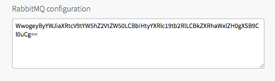

The base64 value can be added in the text box as seen in the image below
