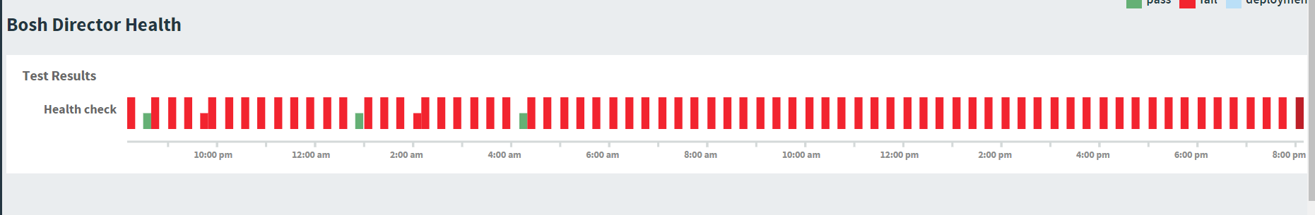

Symptoms:
You noticed on your Health Watch dashboard that director is failing but checking into Ops Manager and your IAAS its up and running.
Check if there any bosh-health-check tasks that are failing
