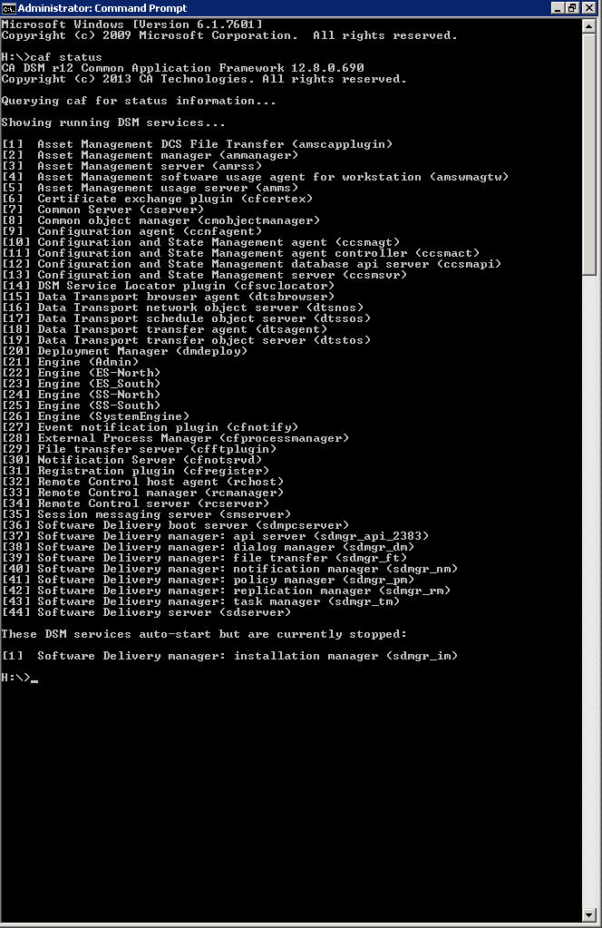

The process, sdmgr_im, responsible for updating job statuses may be stopped. Run CAF status at a DOS prompt on the Domain Manager to check it's status:
The process may be stopped due to a large or corrupted queue. Clearing the IM queue as below should resolve the issue.
