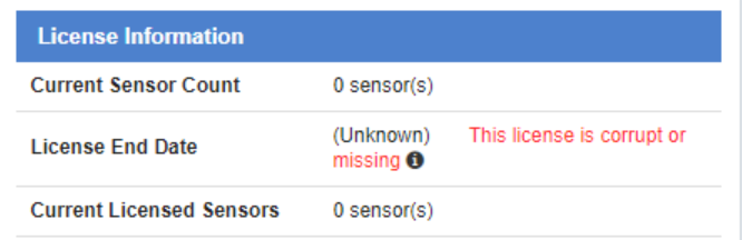

  • When attempting to apply the license from the console, the messages below are seen in the EDR Server Dashboard:
    • User-added image
    • User-added image
  • The following Log files can be seen in the /var/log/cb/coreservices/debug.log:
2020-10-02 10:59:35 [49482] <warning> cb.sensor.license_manager - Unable to write license_file /etc/cb/server.lic
2020-10-02 11:00:13 [49484] <warning> cb.sensor.license_manager - Unable to write license_file /etc/cb/server.lic
  • EDR: All Supported Versions
  • Permissions issue is not allowing the writing of /etc/cb/server.lic
  • Change ownership of /etc/cb/server.lic to the cb user and group.
    • sudo chown cb:cb /etc/cb/server.lic
