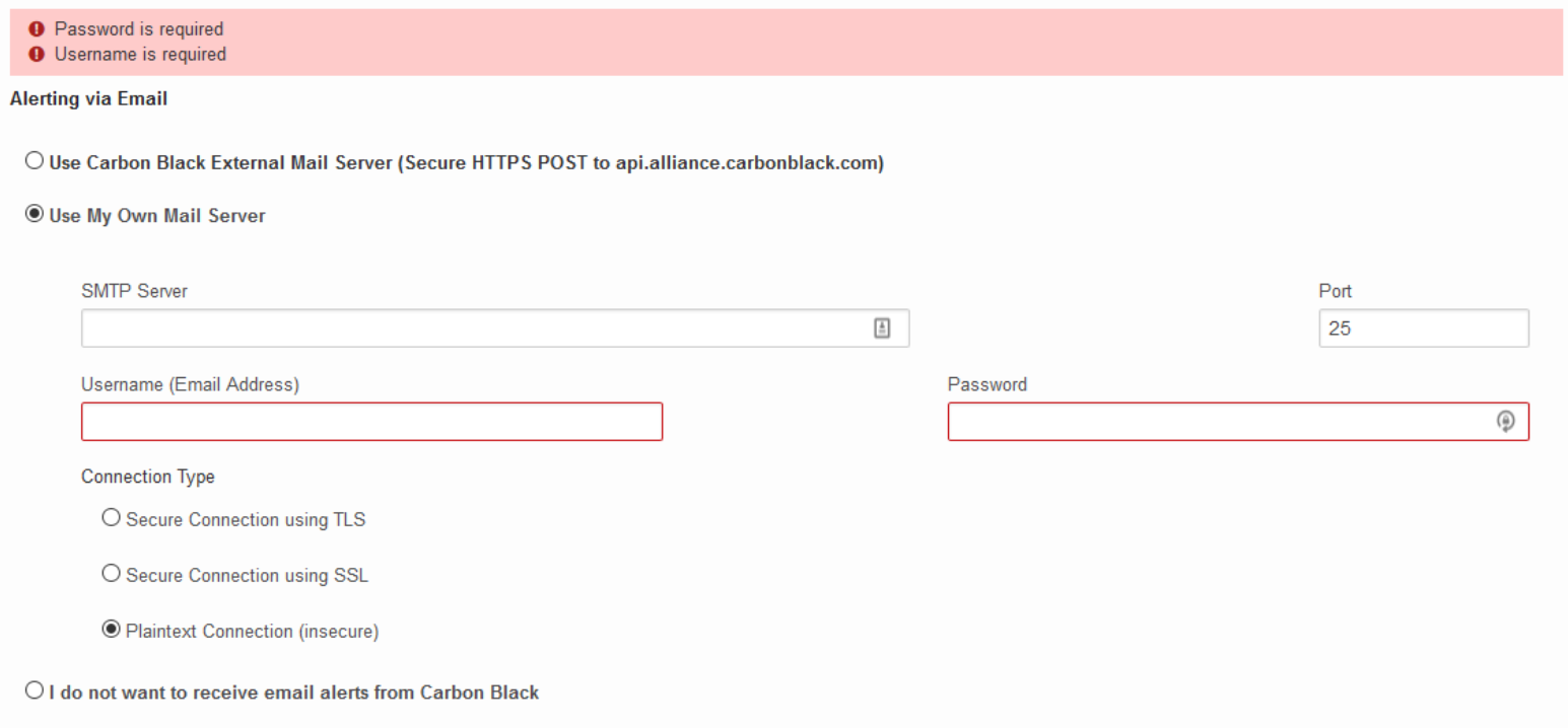

  • Cannot use a blank username or password when entering in email settings :
    • User-added image
  • CB Response Server: 6.2.4 and lower
  • There is a requirement for username and password to be entered on earlier CB Response Server versions.
