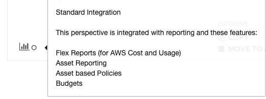

  2. (optional) Once you have reviewed all existing accounts and configured API access for any that require it. I would also suggest you create a new Perspective to help segment the accounts that have already been onboarded into PGB. How to achieve this will depend on your own business logic, but if you need help with this, please sync with your Technical Account Manager.
NOTE: This Perspective does not need to be enabled for Advanced Integration (it should remain as standard integration as it's only to be used for non OLAP reporting) -

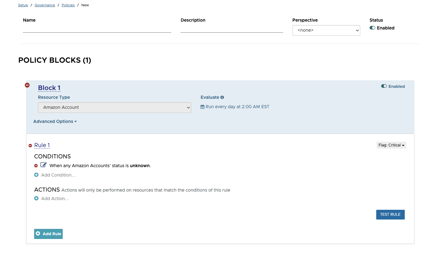

4. If this Subscribed report does not meet your requirements, you could also create a governance policy to alert on accounts in an unknown Status as per -
NOTE: Due to the number of existing accounts that are already in an Unknown Status, I would not recommend using this option unless you first create a Perspective to help you filter the Policy.
