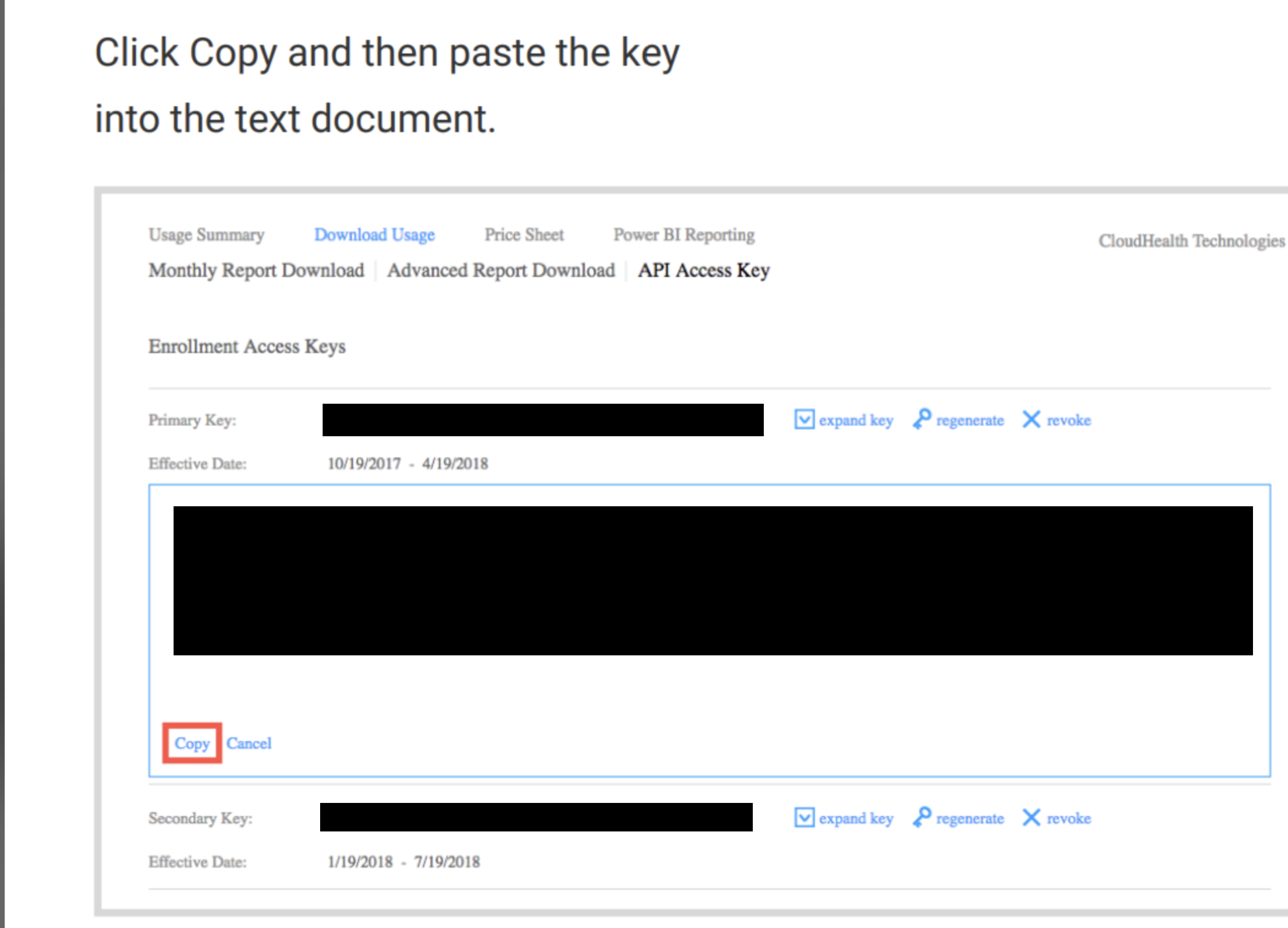

4. From the left menu, click Reports, select the Download Usage tab, and then open the API Access Key page.
5. The user generating the API Access Key must be an Enterprise Enrollment Administrator. Otherwise, the platform is unable to use the key to access the relevant usage reports.
