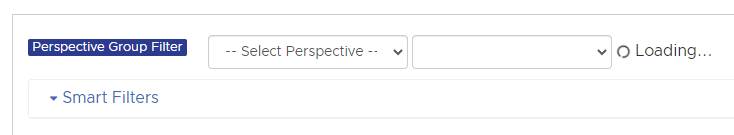

Issue: Perspective Group Filter Continues to Load Indefinitely for a Saved Report
Detail: The issue will occur when attempting to put a Perspective Group Filter and it loads indefinitely without returning any results.  The screenshot below illustrates the issue:
