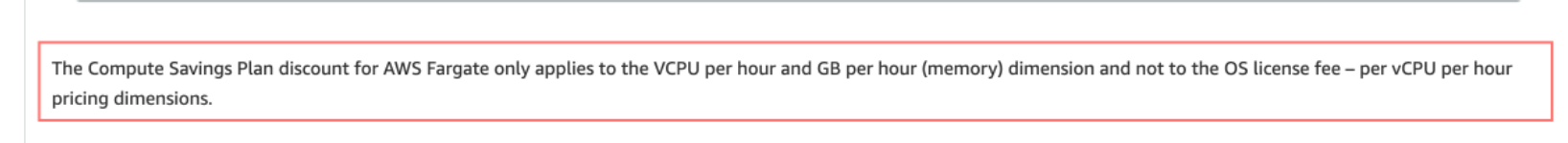

What are the Fargate usages covered under Savings Plan?
Savings Plan for the Fargate can cover both Fargate Compute and Memory but not the Data transfer.
https://aws.amazon.com/savingsplans/compute-pricing/
