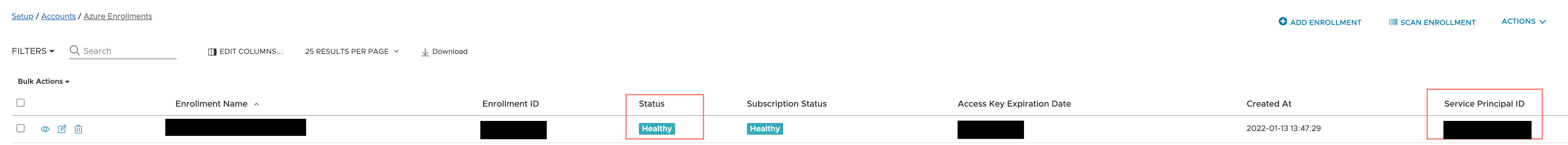

Within the platform:
Make sure the Service Principal is Healthy and Connected to the Active Enrollment Account.
https://apps.cloudhealthtech.com/azure_enrollments

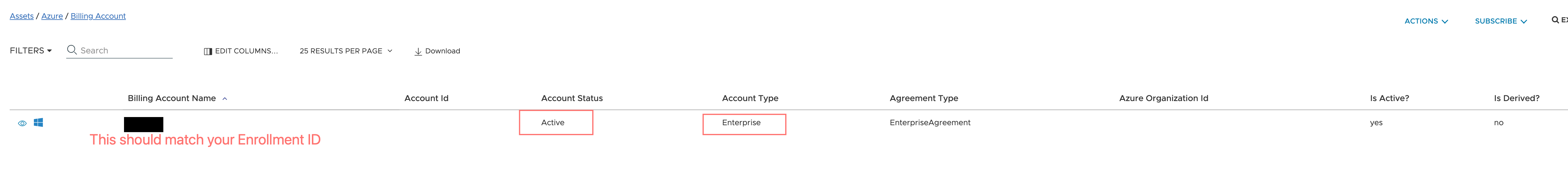

Once the EnrollmentReader Permission is added, it may take ~1Hr to collect the Billing Account asset. Verify the Billing Account asset is visible with the billing account id matching the Enrollment Account ID.
https://apps.cloudhealthtech.com/assets/azure/billing_accounts

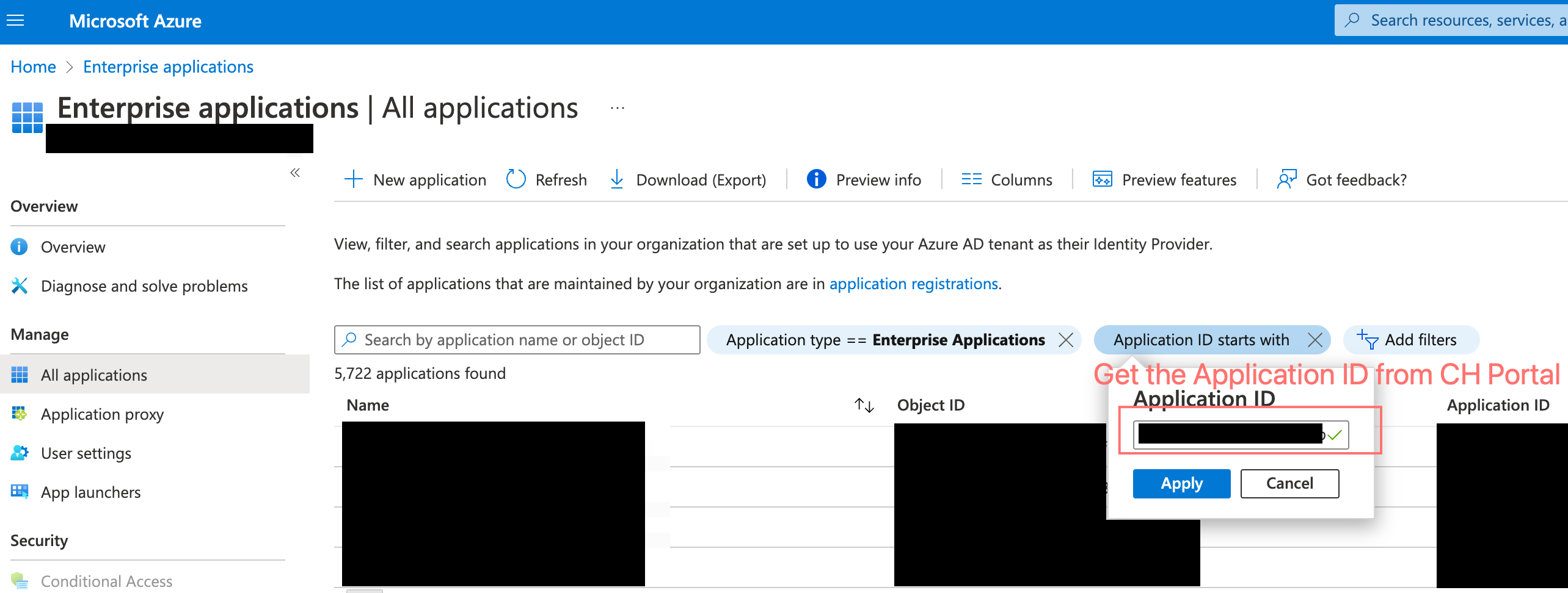

a. Obtain the Object ID for your Service Principal from Azure Portal -> Enterprise Application Portal.
https://portal.azure.com/#view/Microsoft_AAD_IAM/StartboardApplicationsMenuBlade/~/AppAppsPreview

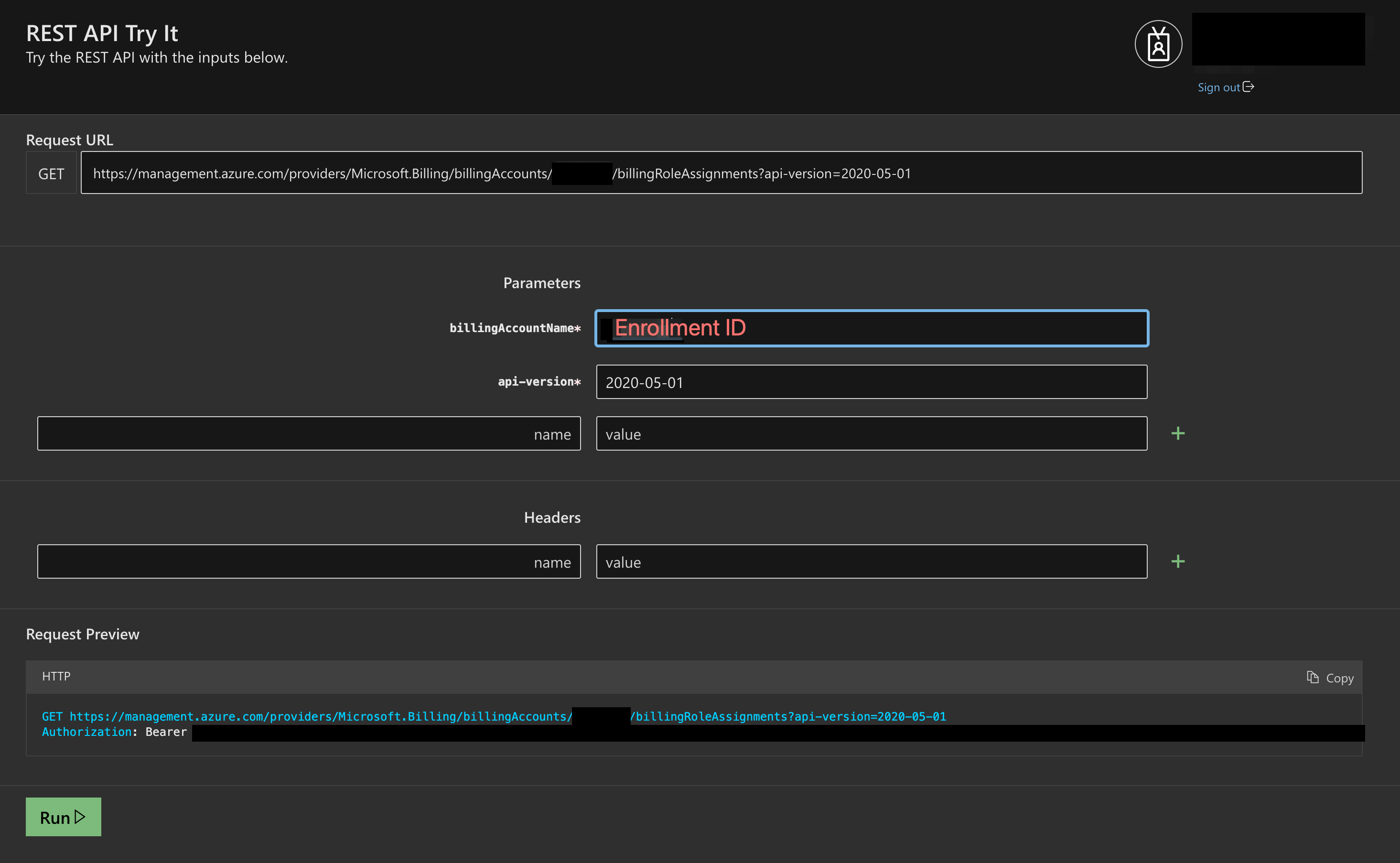

b. Access the below Azure help document and click "Try It".
https://learn.microsoft.com/en-us/rest/api/billing/2020-05-01/billing-role-assignments/list-by-billing-account?tabs=HTTP
c. Sign in with the Azure Administrator Account.
d. Enter the BillingAccountName which will be your Enrollment ID and Click Run.

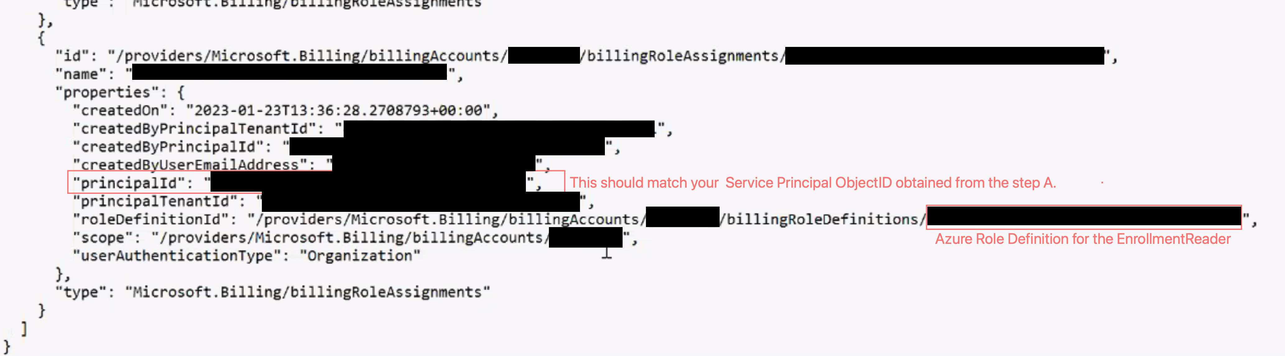

e. Looks for the principal ID (Object ID copied from Step a.) in the response Body JSON.
