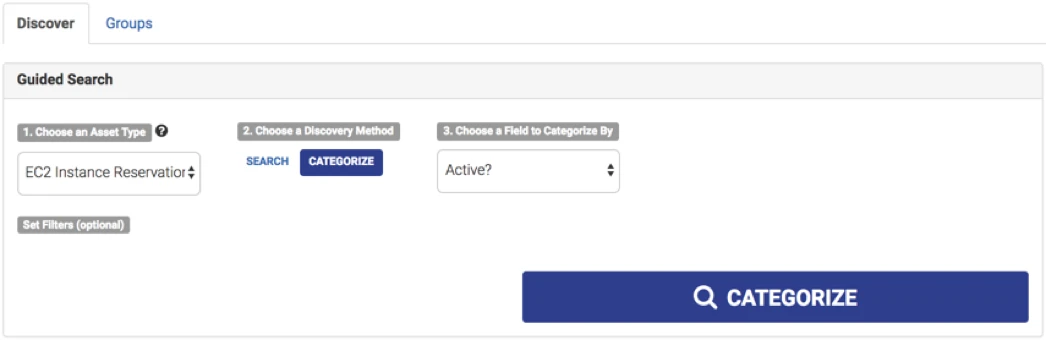

Create a categorized search with Asset Type "EC2 Instance Reservation" and categorize by the field "Active?":

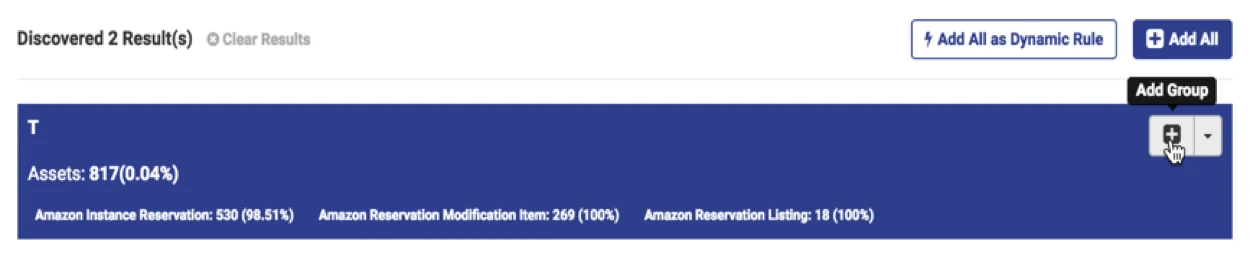

Select "Add Group" next to the "T" group:

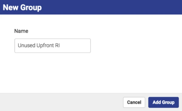

Create a name for the group.  One option could be "Unused Upfront RI"

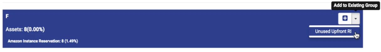

Add the remaining reservations in the "F" group to the group you just created.

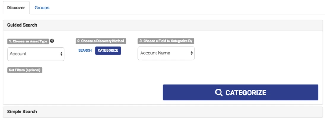

Create a categorized search with Asset Type "Account" and categorize by the field "Account Name"
